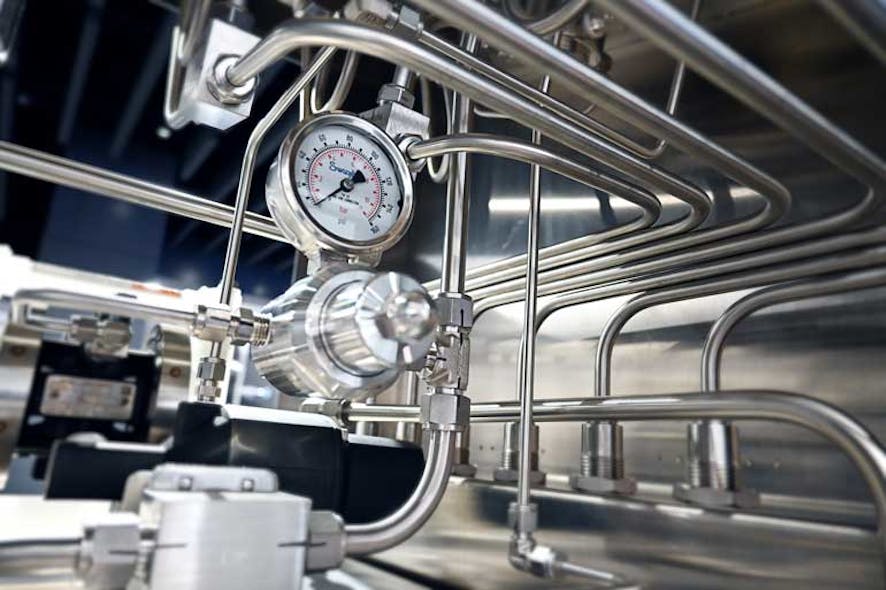

OES designs HPUs that allow for the remote control of offshore oil and gas platform production, which means the components are under immense pressure—somewhere between 20,000 and
60,000 psi. That amount of pressure is necessary to force the hydraulic actuation of equipment from the topside of oil and gas platforms to the sea floor. Performance under those conditions is challenging, and each component, from the pumps to the connections, must work as intended to keep operators and the environment safe.
To improve the safety profile of their HPUs, Gomez and Rogers wanted to remove vibration from the system. Vibration poses a serious risk to drilling components because it can affect connections, causing them to wear, slip or blow out. When any of those problems occur, they can lead to unplanned maintenance and accidents.
When they looked closely at previous HPUs, Gomez and Rogers focused on the medium-pressure ball valve and the use of a compression-end connection. Offshore applications have required cone-and-thread connections to withstand the pressure necessary to execute the operation, but they require the addition of a vibration gland to minimize potential vibration damage. These glands must be installed by a knowledgeable and experienced technician to ensure they work properly, adding another level of complexity to an already complex situation.
Cone-and-thread connections also tend to loosen over time when subjected to vibration and must be tightened manually to ensure leak-tight connections. Gomez and Rogers realized there was a significant opportunity to improve their HPUs by investing in medium-pressure ball valves with tube fitting end connections instead of traditional cone-and-thread connections.
The advanced design of the ball valve Gomez and Rogers chose reduced seal wear and improved the reliability of connections across a full range of operating pressures up to 20,000 psi as well as temperatures. The trunnion-style ball features an innovative direct-load design to enable leak-tight performance and a bottom-loaded stem design to eliminate stem blowout.
Before they decided to commit to using the medium-pressure ball valves in their units, OES had to do its own rigorous testing to ensure they would perform as promised. They found the valve operated smoothly with 100% differential, indicating one side of the valve received all the force while the other side saw none.
Gomez and Rogers found the valve outperformed expectation—while it was rated for 15,000 psi, it held all the way to 22, 000 psi. In addition, the valves acted like an antivibration unit, making it the perfect valve to eliminate vibration as the team at OES hoped to do.
