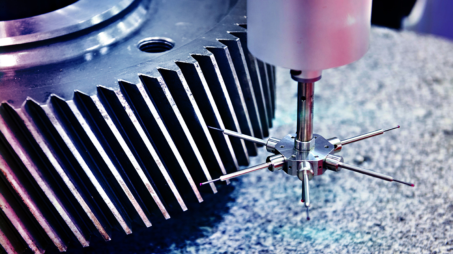

Accurate Clearance Measurements
Precision machining shops often encounter assemblies in which the constituent parts must fit into a space with virtually no clearance, such as when a shaft and hole have the same diameter. That means the tolerance—the maximum permissible variance between dimensions—can be as low as thousandths of a millimeter.
One such assembly involved a spool with an outer diameter of φ8 (0.000/−0.002) and a sleeve inner diameter of φ8 (+0.002/0.000). With such a tight clearance accuracy requirement, AOMI Precision employed an air micrometer and a CNC roundness measuring machine to achieve a proper fit. The air micrometer—which requires extensive operator training and meticulous calibration—injects a fixed amount of air and converts the returned air volume into electrical signals, providing dimensional measurements with sub-micron-level accuracy.
This contactless measurement method is well-suited for inspecting the surfaces of critical devices such as hemolytic pumps. This machine provides a rotational accuracy of 0.015 + 0.0003 μm per millimeter to measure the inner and outer diameter of a workpiece with high repeatability. It can also measure the straightness, parallelism and taper angle of a tapered surface. To ensure uniform measurements, the test equipment used to inspect the assembly is kept in a constant temperature room at all times (20 ± 0.5 ̊C, 50% ± 5%).

If there’s a potential problem during the machining process, the part’s surface finish is likely to provide an early clue. Changes to the roughness or texture of the surface—sometimes called “chatter”—can indicate tool wear, unexpected or improper tool speeds or temperatures. For these reasons, surface measurement is an essential step to ensuring part quality. Many parts have holes that are too difficult to access using traditional surface roughness measuring devices, so a non-contact measuring approach is necessary.
For example, AOMI employs a high-speed, non-contact 3D optical profiler. Its 1,024 × 1,024-pixel array provides a large field of view, and its data specifications include 0.1Å rms resolution, <0.2Å rms repeatability and 0.1% step height repeatability.
Using this scanner, a custom part with a hole-bottom surface roughness of Rzmax0.4 Wz0.3 and hole side surface of φ12.917 mm was measured. The hole depth was 43 mm—out of reach for most surface roughness measuring devices.

Another obstacle to accurate hole measurement is identifying differences between the measured value of a measurement point and the design values specified in the CAD data. Coordinate measuring machines can visually check the error of each measured value obtained to evaluate flatness, roundness and cylindricity in order to examine the unevenness of the plane at a glance. The machines also should include a function to evaluate free-form surfaces.
