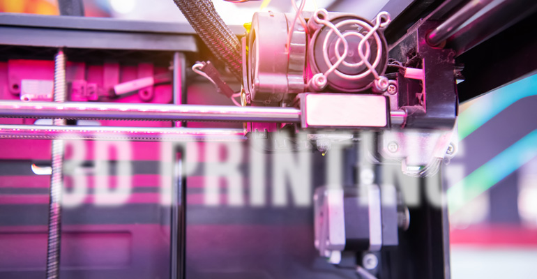

3D Printing
In 1981, Hideo Kodama of Nagoya Municipal Industrial Research Institute published his account of a rapid-prototyping system using photopolymers. In it, solid, printed models are built in layers, each corresponding to a cross-sectional slice in the model.
Three years later, Charles Hull invented stereolithography. It lets designers create 3D models using digital data that can then be used to create tangible objects. The key to stereolithography is an acrylic-based material known as photopolymer, a liquid that solidifies into solid plastic when exposed to a UV laser. By controlling the position and strength of the laser, 3D printers can build parts one layer at a time. This lets designers prototype and test designs without a large upfront investment in manufacturing equipment.
By 1992, 3D Systems developed the first stereolithographic apparatus (SLA), which made it possible to fabricate complex parts, layer by layer, in a fraction of time it had previously taken. That same year, startup DTM made the first selective laser sintering (SLS) machine. It shoots a laser at a powder instead of a liquid.
Since then, 3D printing has taken off. Several materials can be printed, including most polymers, composites, metals and even human biological tissue. Everyday new 3D printing applications are devised, and 3D printing methods continue to evolve.
