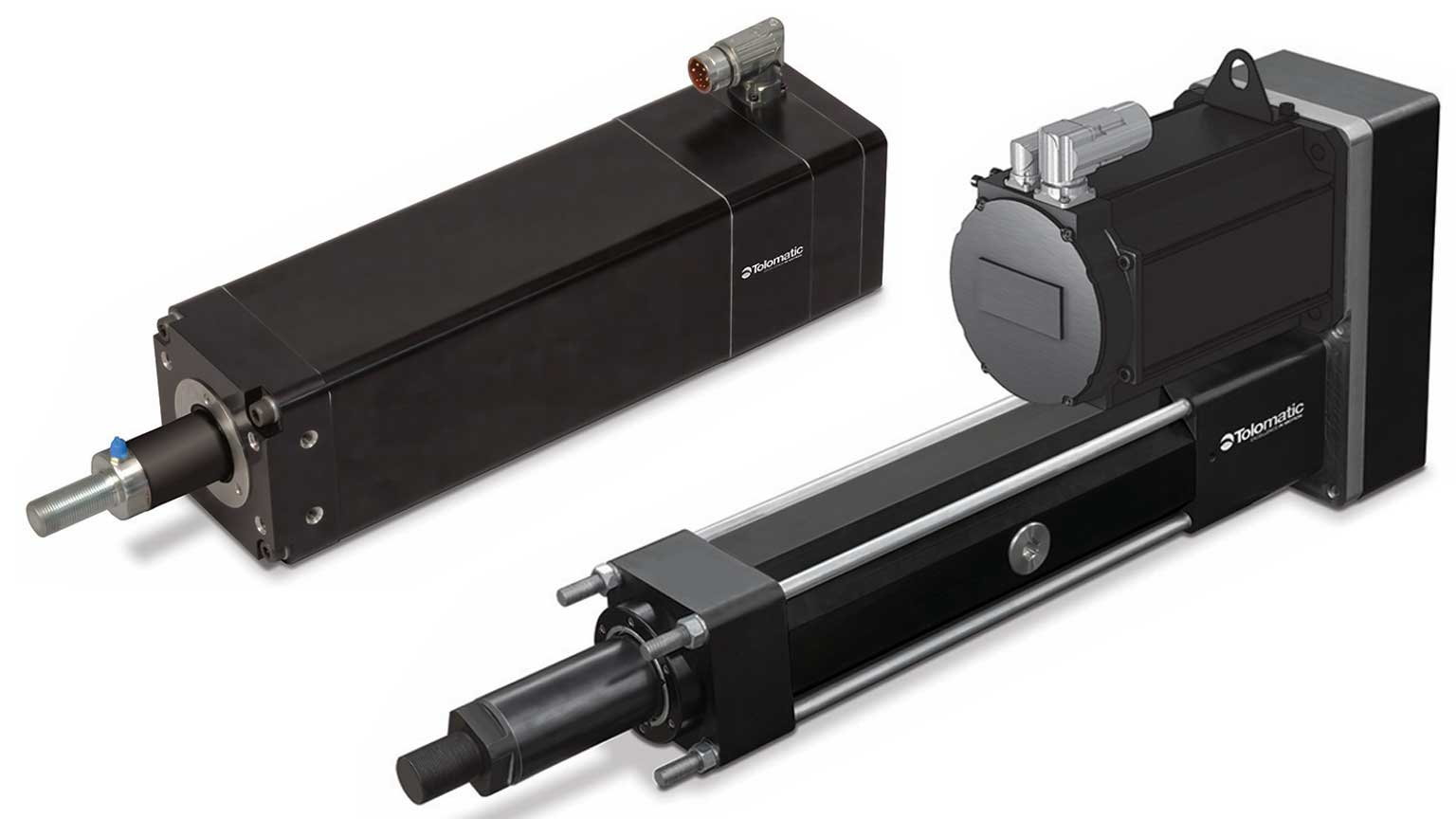

Both of these devices are widely used with electric actuators to move loads linearly, but each has its advantages and disadvantages that make one or the other a better fit for applications.
Ball screws and roller screws are widely used for high-force linear motion and are replacing fluid power devices. In general, these screw mechanisms generate linear motion by rotating either the screw or nut in an assembly. The screw is a cylindrical element with threads, and  the nut is a matching component that rides on the screw. Each component can rotate independently of the other, but the linear motion is created by restraining either the screw or nut.
