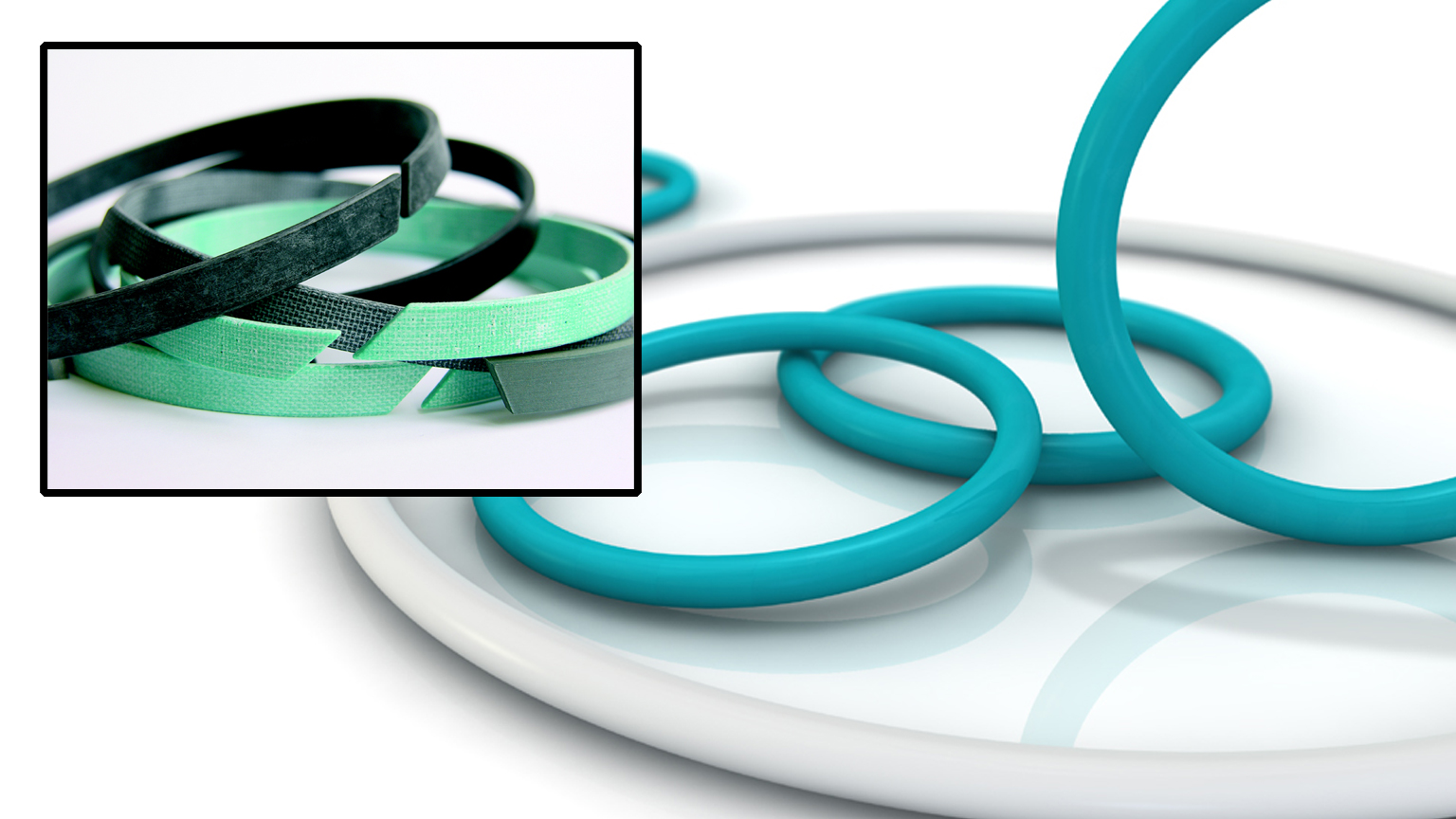

O-rings and guide rings are both used on hydraulic cylinders, but they handle different tasks. O-rings are often the first choice for engineers because of their flexibility and performance in static and semi-dynamic applications, and nearly every sealing configuration in hydraulic cylinders require wear rings. Ultimately, the application and its specifications determine if an O-ring or a guide ring should be used.

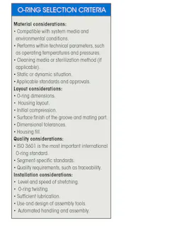

Selecting the Right O-ring
When selecting the type and size of O-ring, design teams should consider four criteria that will maximize seal life and minimize cost: the material, layout, quality and installation.
Engineering teams should tap knowledgeable suppliers for O-ring recommendations based on their experience. There are also several tools to help select and size O-rings, such as Trelleborg’s O-ring Calculator, Compatibility Guide and Sealing Solutions Configurator.
Wear Rings and Guide Rings
Wear rings, also known as guide rings, are used to guide moving components in hydraulic systems. In general, wear rings extend the life of a hydraulic system and can be replaced faster and less expensively than an entire cylinder. They also increase equipment availability and up-time, which is critically important in the fluid power industry.
In hydraulic cylinders, wear rings typically support the piston or rod to help guide movement and optimize seal performance. They can handle radial loads and prevent contact between the piston and bore or rod and cylinder head. They also act as wear components.
