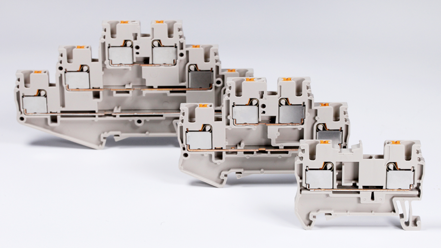

Keeping Circuits Grouped
For control and automation panels, the power distribution circuits—whether 24 V DC or up to 240 V AC—usually require two wires. Signaling applications, such as connectivity to sensors, are typically 2-wire or 3-wire, and may require an additional shield connection for analog signals.

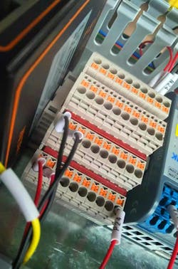

Certainly, it is possible to install all these wire connections across many single-level terminal blocks. However, there are many initial and ongoing benefits to stacking all the connections for a given circuit into one multi-level terminal block (Fig. 2).
Multiple conductors making up a circuit, especially for analog signals, are often run in one multi-conductor cable instead of as individual conductors. Because they are already grouped within one cable, it simply makes sense to terminate all of these related conductors onto one multi-level terminal block, instead of several single-level terminal blocks. Multi-level terminal blocks speed up installation, and they make it easier for personnel to troubleshoot any issues because all of the conductors are close together (Fig. 3).
One possible downside of multi-level terminal blocks is if they are so small that it is hard to work with the multiple conductors involved. As long as the physical dimensions are balanced and marking provisions are clear, the benefit of higher wiring density takes precedence. For a typical 2.5mm2 size connection terminal block, the overall three-level terminal block thickness may be only 5.1mm, yet six conductors can be terminated, saving 66% of the valuable control panel space as compared with using single-level terminal blocks.
Grounding, or potential-earth (PE) connections, are another consideration. When used with shielded two-conductor signal cables, a three-level terminal block with pass-through conductors for the two top levels and a PE connection for the bottom level is convenient for landing the cable, and ensuring grounding of the shield to the DIN rail and cabinet. Where a high density of grounding connections is needed, a two-level terminal block with all points providing a PE connection provides the most grounding connections in the smallest space.
