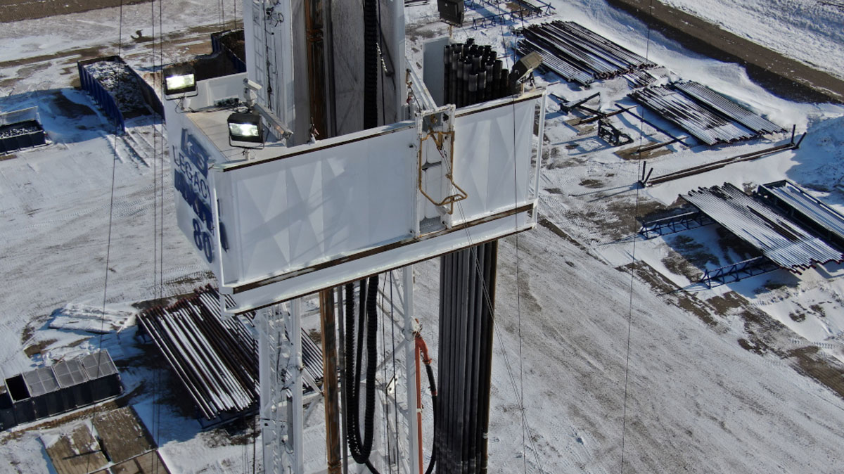

The e-loop energy chain includes several other benefits for drilling rigs. The igus product combines the advantages of a polymer energy chain with a Dyneema rope featuring high tensile strength. The tensile forces are absorbed by the rope and passed through the mounting brackets into the support structure. The design relieves cables of any strain and ensures a defined bend radius of the cables. The modular e-loop also withstands vibrations and shocks.
“Less downtime results in more productivity, and less damage to the rig saves money,’’ Amyotte said. “There is also an important safety component. There is 600 V AC running through those power cords and up to 600 amps before the breaker trips.”
The e-loop has a bend radius of 500 mm and includes a protective cable guidance system that eliminates service loop cable snags and hang-ups. Its modular design allows easy pre- and post-installation access. The design also makes it safer for repairs. igus, which runs its North American operations out of Providence, R.I., manufactures self-lubricating, long-lasting components that are used in a wide range of applications.
The e-loop is mounted in the middle of the mast, which is a load-bearing structure used to support and position the drill string. The e-loop traverses the 136-ft mast by going 70 ft up and 70 ft down from the center point.
