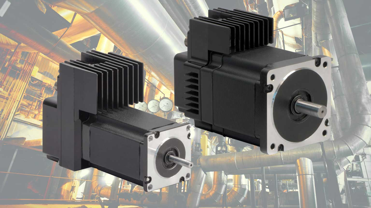

Motor Selection
Here are some general guidelines for choosing between steppers and servos:
  • If low cost is needed, a stepper is a good choice.
  • If loads are unpredictable and create extra torque requirements, a servo is a good choice.
  • If complete reliability even with power loss is needed, a servo should be chosen.
  • If it’s a low speed or low torque application, a stepper should be used.
Engineers may need to go through the specific characteristics of the motors and look at the pros and cons of each for applications they are working on.
However, if there is no clear choice on motor type because features of both steppers and servos are needed, perhaps a stepper with servo control is a good option.
There is also a new type of motor being used: the hybrid stepper. The ServoStep motor offers the benefits of steppers and servos by having some characteristics of both. They provide a closed loop on the stepper motor to get some of the advantages of the servo control.
Stepper and servo motors offer a wide array of features that can benefit specific applications. The key is understanding what the application requires and selecting a motor that best meets application requirements and complies with engineering specifications. While this article offers the basic information needed to choose the motor type for an electric actuator application, there are also other elements needed to complete the system. These include a drive/controller, smart controller, serial or discrete control, and proper sizing for the application.
