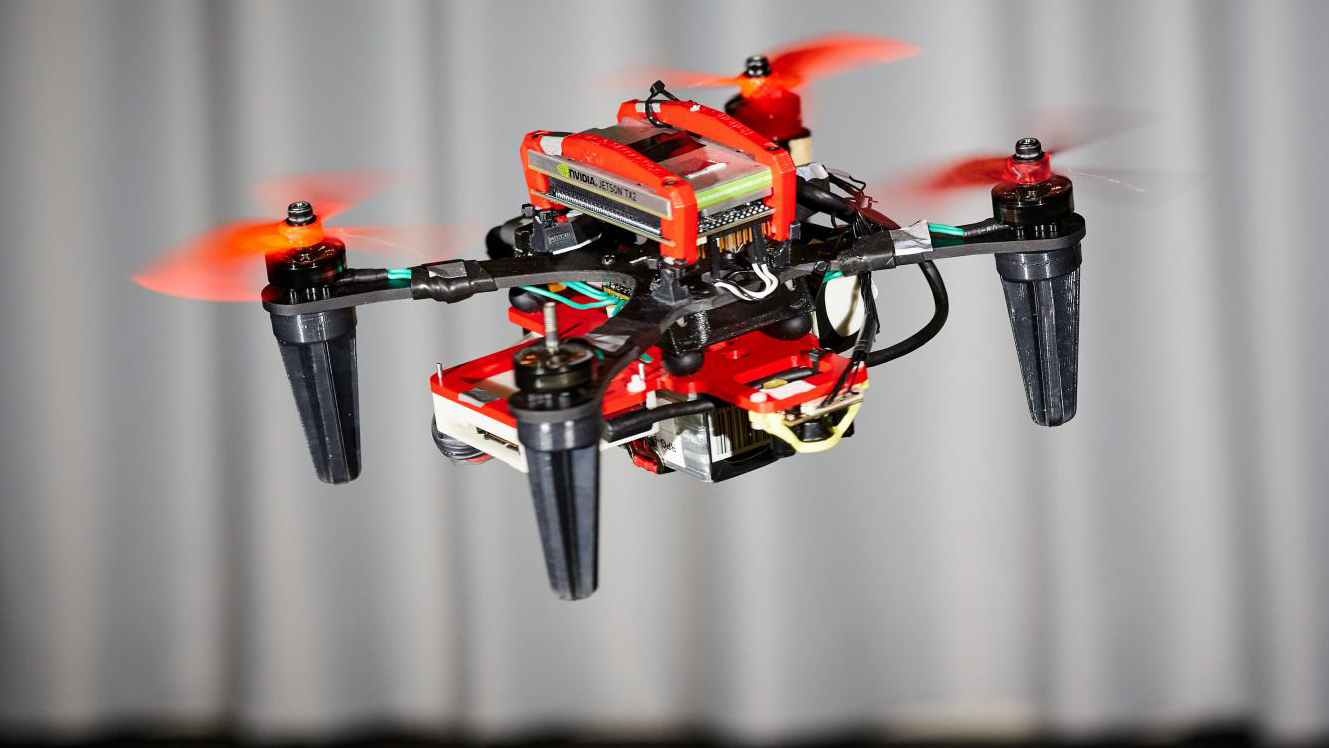

With only three rotors working, the drone loses stability and inevitably crashes, said researchers at the University of Zurich and the Delft University of Technology.
They have a solution to the problem: an emergency control strategy that uses information from onboard cameras to stabilize the drone. Moreover, they said, the solution can keep the drone flying autonomously after one rotor suddenly gives out.
“When one rotor fails, the drone begins to spin on itself like a ballerina,” explains Davide Scaramuzza, head of the Robotics and Perception Group at UZH and of the Rescue Robotics grand challenge at NCCR Robotics, which funded the research.
He said that high-speed rotational motion causes standard controllers to fail unless the drone has access to accurate position measurements. Once the drone starts spinning, it loses its ability to estimate its position in the air and eventually crashes.
One way to address this problem is to provide the drone with a reference position through GPS. However, the problem persists in places where GPS signals aren’t available. The researchers instead offered a solution using visual information from different types of onboard cameras.
How It’s Done
Two sets of cameras were attached to the quadcopters:
  • Standard cameras—these record images several times per second at a fixed rate.
  • Event cameras—these are based on independent pixels that are only activated when they detect a change in the light that reaches them.
Next, the team developed algorithms that combine information from the two sensors and use it to track the quadrotor’s position relative to its surroundings. The researchers explained that this configuration enables the onboard computer to control the drone as it flies—and spins—with only three rotors.
Although both types of cameras perform well in normal light conditions, the standard cameras become ineffective in weak lighting. “Standard cameras begin to experience motion blur [when illumination decreases]; that ultimately disorients the drone and crashes it, whereas event cameras also work well in very low light,” said first author Sihao Sun, a postdoc in Scaramuzza’s lab.
Further Direction
The in-development solution is a milestone for drone technology, especially as quadcopters become more prevalent. Rotor failure may cause accidents, noted the researchers, and this work can improve quadrotor flight safety in places where GPS signals are weak or absent.
