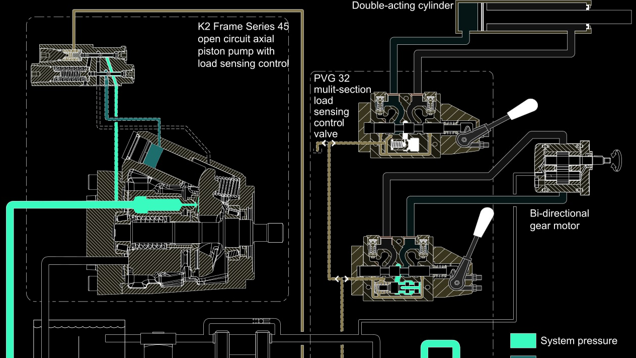

Open-Circuit Designs
In contrast to closed-circuit hydraulic systems, suction filtration is not a recommended filtration method with open-circuit pumps. This is due to the potential for high inlet vacuum to occur. Instead, a screen is recommended in the reservoir covering the pump inlet. A 125 µm (150 mesh) screen protects the pump from course particle ingression.
Return line filtration, with the filter in the return line to the reservoir, is often the preferred method in open-circuit systems. All the fluid in the system passes through the filter as it returns to the reservoir.
