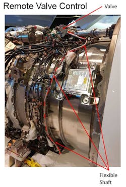

One unsung player in this process is the flexible shaft used to transmit mechanical rotary motion, which actuates a valve or other component. The shaft must be flexible so it can be routed over, under and around obstacles to reach a valve that could located deep within an engine. The flexible shaft also lets the override control be mounted in a convenient position where the pilot or mechanic can remotely operate the components. The override controls are often located inside an accessible latched compartment.
Two components on airliners that often have this type of manual override are air-turbine-starter (ATS) valves and the anti-icing valves. The ATS valve controls compressed air as it goes from the ground or auxiliary power unit (APU) to the starter. The starter spins the engines to get them started on the ground, which then provide electrical power for instruments and cabin air. At this point the APU can be turned off. The anti-icing valves route hot air from the engines to the engine intakes and leading edges of the wings to prevent ice from forming.

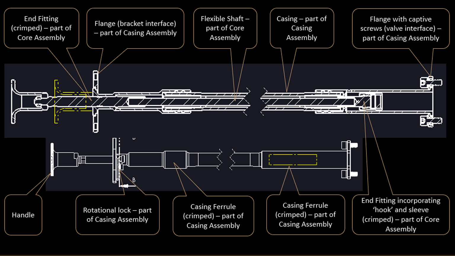

A flexible shaft is a precisely defined and configured nested group of springs, tightly wound to give it torsional or rotational strength; this lets the springs bend, but also still rotate. They transmit rotary motion much like a solid shaft but can be routed around obstacles, such as the innards of an engine.

The interface that users places their hand or tool on to operate the shaft can take a variety of forms.
For example, there can be a male or female receiver for a standard wrench, or a crank handle that is part of the shaft assembly. In cold climates, maintenance crews might be wearing bulky gloves, so there should be enough space around the controls to accommodate the gloves, especially if crews must disengage a lock before turning the flex shaft. Similarly, if there are hot surfaces near the device, the shaft would have to be far enough from the operator to avoid burning them.
