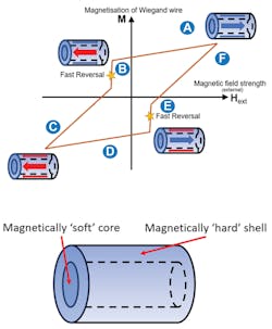

The Wiegand Cycle
A. At the beginning of the cycle, the magnetic polarity of the outer shell and the inner core are the same.
B. When the wire is exposed to a moderate external field in the opposite direction, the outer layer of the wire shields the core, and both retain their original magnetic polarity. However, when the strength of the external field reaches a critical threshold, the influence of this shielding effect is overwhelmed and the polarity of the core of the wire will suddenly reverse. This sudden change in polarity creates a current pulse in the coil surrounding the wire.
C.  The combination of the strengthening external field and the reversed polarity of the inner core cause the magnetic polarity of the outer shell to reverse as well.
D.  As the external field diminishes, the wire retains its new polarity.
E. When the external field (now reversed) reaches the critical threshold, the core material of the Wiegand wire will flip back to its original polarity, producing a current pulse in the surrounding coil.
F. This is followed quickly by a reversal of the polarity of the outer core. The wire is now back in State A.
