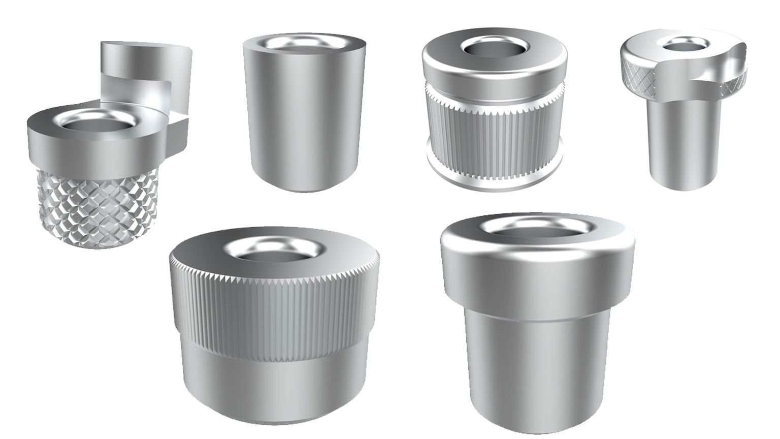

Designers and machine shops have a variety of bushings to handle different types of drilling applications.
Drill bushing are mainly used as guides for cutting tools, but they are also used in fixtures for assembly and inspection tools, as well as other applications require precise alignment and location of cylindrical parts.
One common application for drill bushings is to support twist drills, which are efficient at making holes but difficult to center. As a result, it is notoriously inaccurate at creating holes in an exact location. Drilled holes are often off-center, oversized, out of round, out of alignment and not straight. However, supporting the twist drill with a drill bushing greatly reduces, if not eliminates, most of these problems.
Drill bushings are identified by an alphanumeric code that describe the bushing’s form and size in a format established by the American National Standards Institute (ANSI). This format consists of one to four letters identifying the bushing type, followed by its OD (in 1/64-in. increments), length (in 1/16-in. increments), and the bushing’s ID stated to four decimal positions.
There are three general categories of drill bushings: permanent bushings, renewable bushings and air-feed-drill bushings.

Press-fit bushings (type P or PC if the bushing is carbide) are the most common and least expensive and are identified by the code They are used in one-step operations such as drilling or reaming. The bushings are pressed directly into the fixture and held in place by the force of the press fit. The headless design lets bushings be mounted close together and flush with the top of the jig plate. This design, however, offers little resistance to heavy axial loads.
Head-press-fit bushings (type H or HC) are like press-fit bushings but have a head. They are used for applications in which heavy axial loads might push a press-fit bushing through the mounting hole. They bushings can be installed with head exposed or counterbored if the bushing must be flush with the top of the fixture. When counterbored, only the busing body’s diameter needs to be reamed to locate the hole. The counterbored area provides clearance for the head and should not be a precision fit. The length of the bushing is measured from the underside of the head to the bottom of the bushing.
Serrated press-fit bushings (type SP) are for applications in which a hardened drill bushing is mounted in a soft jig plate. The bushings’ mounting surface has a precision-ground diameter and a serrated or straight-knurled area. The ground portion aligns the bushing in the mounting hole. The serrations prevent high torque loads from causing the bushing to rotate. The serrations also resist axial loads that could push the bushing through the jig plate. These bushings are well suited for fixtures made from aluminum, magnesium, Masonite, wood and similar soft materials.
Serrated-groove bushings (type SG) are serrated over their entire length. The serrations and grooves cut around the bushing’s circumference lets them be used in pressed-in or cast-in-place applications. These bushings offer high torque resistance, but their straight-knurled mounting surfaces reduces their resistance to axial loads. Similarly, the circumference of these bushings is serrated and not ground, so the internal diameter must be used to align the bushing for cast-in-place applications.
Diamond-groove bushings (type DG) are for cast-in-place applications and not press-fit applications. They resemble serrated-groove bushings, but have a diamond knurl rather than straight knurl on the circumference. The diamond knurl better resists rotational and axial forces. Like the serrated-groove bushings, the circumference of diamond-groove bushings is knurled and not ground, so the internal diameter must be used to align the bushings. These bushings are installed in holes with diameters larger than that of the bushing. The space between the bushing and the inside of the hole gets filled with an epoxy resin or a low melting-point alloy.
Template bushings (type TB) are designed for thin jig plates. They let larger diameter tools be used with thin jig plates. Rather than using a thicker jig plate normally required to support larger diameter drills, template bushings provide the necessary drill support in jig plates from 1/16 to 3/8-in. thick. This reduces the jig plate’s cost and weight. Once properly located, the mounting hole is drilled and reamed .001 to .003 in. larger than the bushing’s mounting diameter. The hole is countersunk on the workpiece side letting the bushing seat 0.015 in. below the surface.
