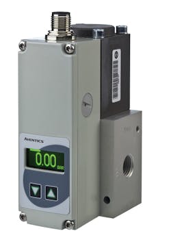

Proportional Valves With Advanced Capabilities
Currently, the most advanced designs are looking to the Industrial Internet of Things (IIoT) to optimize the performance and service life of a proportional pressure valve. Aventics’ Sentronic valves can be applied to a broad range of specialist machinery applications, while the company’s engineering services can help customize products or manifolds. That ensures proper fit, cost-effectiveness and inclusion of all the features needed for an application.
The Sentronic Series of valves are available in various designs. Both the Sentronic Plus direct-acting and Sentronic LP solenoid air-piloted models are available with IO-Link communication. IO-Link communication supports future implementation of Industry 4.0 and IIoT applications that will contribute toward greater plant reliability, availability and profitability. IO-Link is increasingly being applied to a range of automation applications, providing a cost-effective digital communication interface for sensors, actuators and controllers.
To reduce maintenance time and complexity, the IO-Link module allows the Sentronic valves to identify and configure themselves automatically during component replacement, thereby eliminating the need for configuration via a laptop. The addition of IO-Link technology enables device parameters to be changed directly with the PLC without using data acquisition software.
The entire Sentronic portfolio, however, can be customized for a wide variety of applications using an included data acquisition software that grants access to the PID control loop of the valves. This software includes an oscilloscope feature that charts valve performance PID output and PID variables right in the application—a valuable tool during prototype design. Design engineers can get visual confirmation of pressure control as machine designs are modified. In addition to PID parameters, other variables and features (such as deadband, custom ramps and digital outputs) can all be adjusted as per application needs.
Aventics’ Sentronic series of valves can be configured for double-loop (cascaded) control, which means that multiple feedback components can be incorporated. Each feedback loop would be involved in monitoring a different variable, such as pressure, flow, force, speed or temperature. The only additional component needed would be the sensor that provides the feedback.
