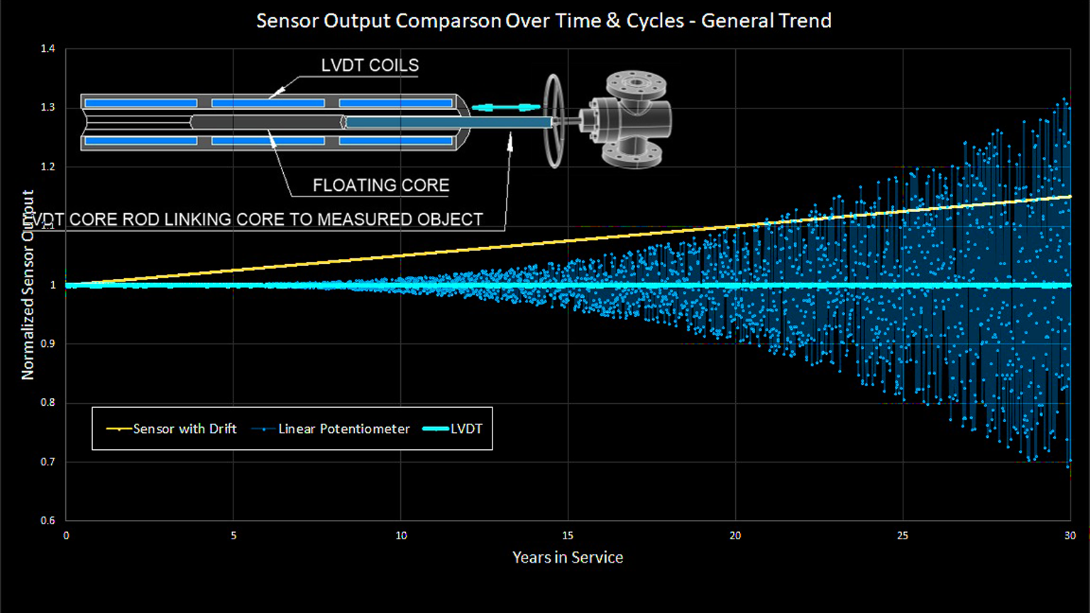

Fig. 3

Repeatability
Many industrial processes require precise product placement at high consistency. Immune to drifts, wear, vibration or foreign matter intrusion, and unlike other sensor technology (Fig. 3), LVDTs exhibit excellent repeatability at any point within their range for extremely consistent output at any given position. Reliability is critically important for applications such as structural monitoring and product thickness measurement that require measurement of extreme small movements over many years.
