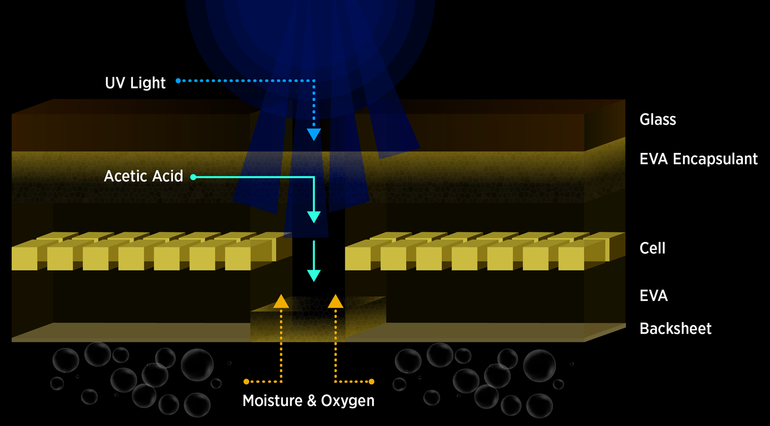

How could the walled-off interior degraded more quickly than the exposed outer layer? Gu and her team speculated that the sunlight-induced degradation of the top side of the encapsulant, a film that surrounds the solar cells, created damaging chemicals that went down toward the backsheets, speeding up their decay. The proposed mechanism would explain why cracks form in between solar cells, as chemicals could find passage to the back through these regions.
Researchers identified acetic acid as a prime suspect, as it is known to be harmful to polyamide when the polymer commonly used as an encapsulant (ethylene vinyl acetate) degrades. To test their theory, the researchers put several polyamide strips in vials of acetic acid and after five months, then analyzed how they decayed compared with strips placed in either air or water.
Under the microscope, the strips exposed to acetic acid had cracks that mirrored those from the weathered backsheets, and they looked much worse than those on strips that had been in air or water. Chemical analysis showed higher concentrations of polyamide’s degradation products of polyamide in the acetic-acid-exposed strips, providing further evidence the acid accelerates deterioration of the backsheet material.
The study indicates the interplay between solar panel components (the EVA encapsulant and polyamide backsheet in this case) are potentially critical factors to consider when designing solar panels.
