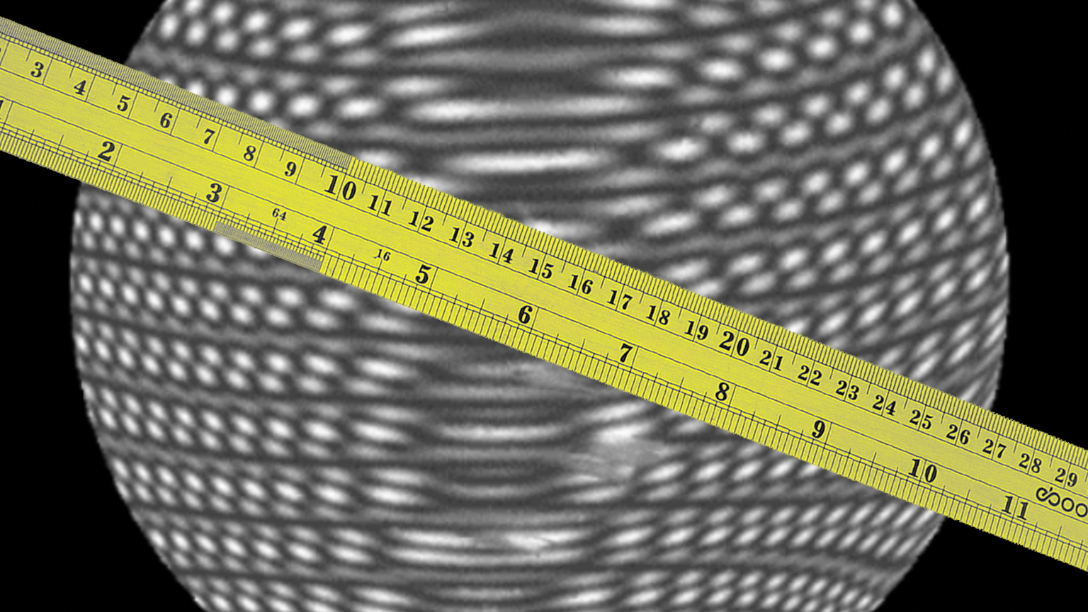

Inherently, measuring thin, parallel optical surfaces can be extremely taxing. The optics are less than a few millimeters thick, and this means the front and back surfaces are very close together. Because of this, standard mechanical phase shifting interferometry (PSI),which was used to examine optics for consumer devices and semiconductors, is now difficult to use on the smaller optics.
A more advanced approach, Fourier-transform phase-shifting interferometry (FTPSI), makes it simpler to characterize the front and back surfaces, variations in optical thickness variation and the homogeneity  of the glass itself. FTPSI can distinguish between the front and back surfaces and characterize the quality of both in a single measurement, even if the lens is less than a millimeter thick.

When the front surface of a thin, parallel part is aligned, the back surface typically sends a second reflection to the interferometer. This results in a complex fringe pattern created by several, overlapping interferograms that cannot be accurately analyzed using PSI.
This could be fixed, but to do so is time consuming and adds unnecessary and potentially damaging steps to the overall process. These include applying black paint to the back surface to extinguish its reflection, coloring it with a dark colored marker or spreading petroleum jelly on the surface.
The FTPSI method makes it unnecessary to manually manipulate the optic’s back surface to get meaningful and accurate measurements. Instead, FTPSI back-surface’s refection to get more information about the optics in a single measurement.
This is possible because FTPSI does not require mechanical motion within the test cavity to create interferograms. Instead, FTPSI relies on wavelength modulation of the laser source to make measurements possible. Each cavity in the optical path in an FTPSI acquisition creates a unique interference frequency that defines its cavity length, and this lets operates clearly delineate and accurately characterize the surface. Algorithms can then analyze both surfaces and characterize their form independently.
