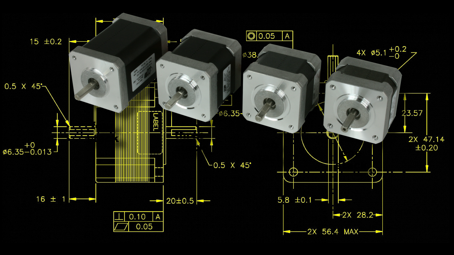

Larger frame size step motors create more torque than smaller-sized motors. Although they increase torque, these larger motors don’t always fit in an application’s limited space. However, if the primary space limitation is motor diameter, engineers can increase step-motor torque within a given frame size by increasing the motor’s length. To build a step motor with higher torque, several rotor and stator sections are “stacked” together, thus the increased length. The step motor generates more torque at the expense of being longer, but not wider or taller. The effect of stack length in size 17 motors can be seen in the nearby image.
The chart here shows typical holding torque specifications (in units of Newton-meters) for motors of varying frame sizes and stack lengths. Different stack lengths within a frame size give engineers flexibility when selecting motors for an application. Sometimes space is available for a longer motor, and other times it is advantageous to use a shorter motor with larger frame size.
