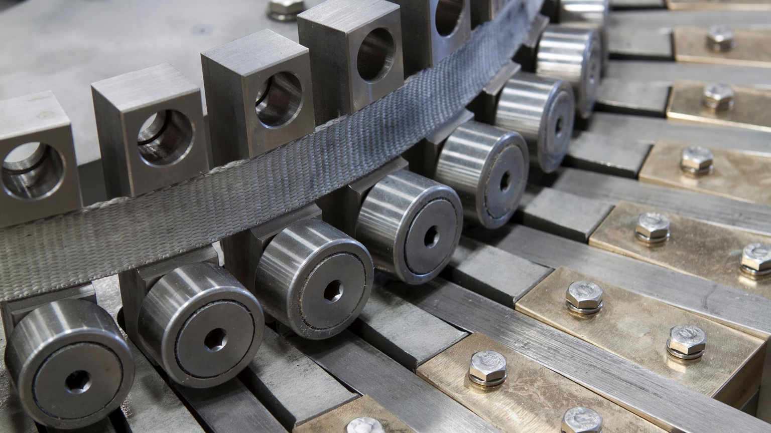

Cam followers convert rotary to linear motion and range from simple two-dimensional cams to complex three-dimensional indexing cams with several followers. In linear-motion applications, cam followers support lateral or vertical travel, such as rollers for platform support and die transfer. In any application, cam follower bearings reduce sliding friction and wear on the cam and track, which lets it maintain its precision. Overall, the choice of which type of bearing is used affects the cam follower’s performance.
Basic Types
There are three types of cam followers: standard stud, heavy stud and yoke. Stud types are mounted cantilever-style in a support housing. Heavy stud versions are for heavy loads, shock loading and applications requiring minimal deflection. Except for the stud diameter and end plate design, standard and heavy stud versions are virtually identical.
The yoke version mounts on a pin with a straddle or yoke support. Yoke mounting distributes loads more uniformly over the bearing, so the working load limit for yoke-type followers are generally equal to that of heavy stud followers.
Most cam follower bearings contain needle rolling elements. These bearings are well suited for supporting radial loads but not thrust loads. An alternative to standard needle rollers is a double row of cylindrical roller elements. The rollers have larger diameters than needle-roller cam followers of the same size. Thus, cylindrical rollers typically provide higher radial load ratings and can support a light thrust load along with the radial load.
Another type of track roller bearing consists of deep-groove ball bearings or tapered roller bearing assemblies. Units with ball bearings or tapered roller bearings support radial and thrust loads, and in certain applications can support pure thrust load. Such units typically have ball bearings for rolling diameters less than 3 in. and tapered roller bearings for rolling diameters 3 in. and larger. These track roller bearings have large lubricant reservoirs and are sealed, so they can operate in dirty environments without lubrication maintenance.
Track roller bearings also come with several different roller profiles (flanged, V-groove, cylindrical), letting them ride on different types of tracks or perform multiple functions. Cylindrical rollers operate on flat tracks. Flanged and V-shaped rollers maintain an maintain position on a rail or edge. V-rollers also operate on special “V” tracks, square or round bars, and sometimes angle-iron tracks.
