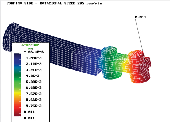

FEA results show high stress areas where the cam followers mount on the tail pin. Later design iterations reduced these stresses by beefing up the transition between the pin’s full cross section and the thinner tail.
We analyzed the wear patterns and found that much of it came from an obvious source — metal-on-metal contact between the pin and barrel, and between the cam followers and drive cams. Without lubrication, the ram would quickly fail.
A less-obvious source of wear emerged from a finite-element analysis of the ram. We simulated not only the forces needed to extrude the can neck but also the related centrifugal and acceleration forces. What we found was that the ram deflected upwards and twisted. This deflection significantly increased the effects of metal-on-metal wear throughout the ram assembly. In particular, centrifugal and acceleration forces contributed to wear on the leading edge of the ram body and its keyway, resulting in a telltale “pleating defect” on the can neck.
