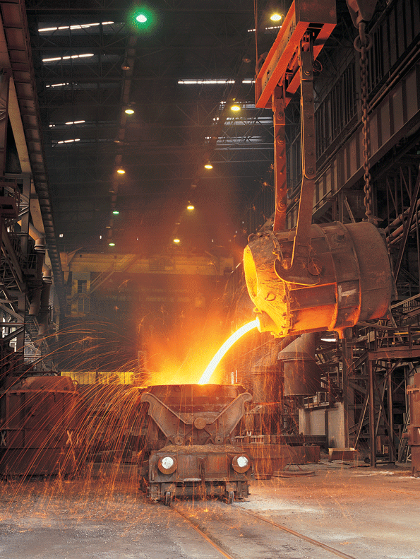

SAE designations are four- and five-digit codes that identify the chemical composition of carbon and alloy steels.
Image courtesy of Thinkstock
