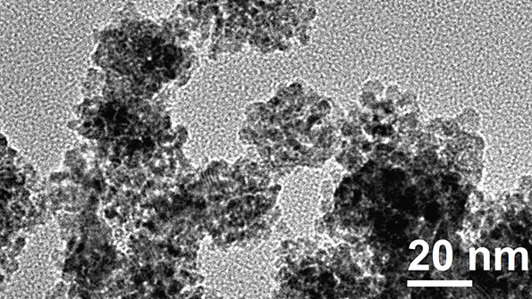

An electron micrograph shows the catalyst on high surface area ceria

CMI scientists, along with the department of Chemistry at Iowa State University and Oak Ridge National Laboratory, successfully created a method to catalyze the conversion. It’s performed at ambient pressure and room temperature, and doesn’t require high levels of hydrogen. A cerium-based material called high-surface-area (HSA) ceria is used as a scaffold to palladium, which acts as the catalyst. The HSA ceria platform contains nanometer particles that distribute the catalyst in reduction reactions. The full chemical reaction is detailed in the ACS Catalysis Journal.
