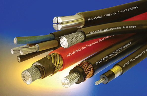

Al cables with fine-wire stranding help flexibility to enhance installation and their use in applications where a small bend radius is required.
