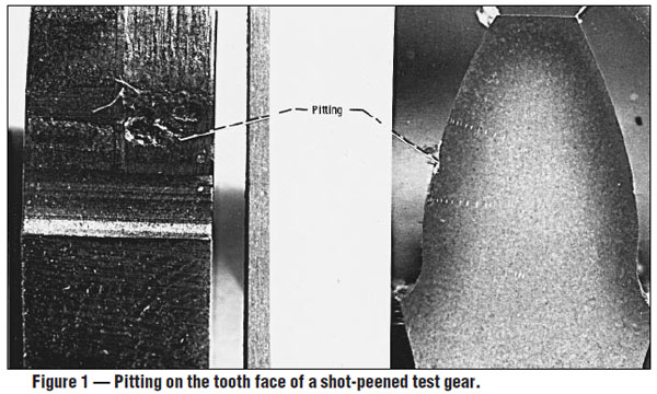

Gears were tested at a temperature of 170 F and a speed of 10,000 rpm, with a maximum Hertz stress of 248,000 psi at the contact surface. Figure 1 illustrates typical pitting of the tooth contact area during the tests.

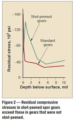

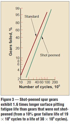

Residual compressive stresses in the shot-peened gears increased 40% over the standard gears at a depth of maximum shear stress (7 mil) for the load conditions, Figure 2. These compressive stresses improved the surface fatigue life, or pitting resistance, of the gears by 1.6 times compared to those that were not shot peened, Figure 3.

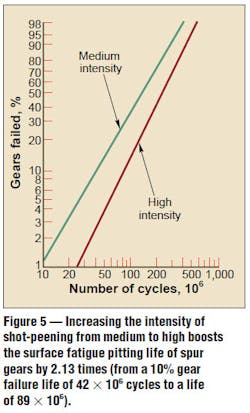

Researchers peened one set of gears to a medium intensity (7 to 9A) and the second set to high intensity (15 to 17A). Both sets were honed after peening to improve the surface finish to 16μ min. rms. As in the earlier tests, gears had 28 teeth and a 3.5-in. pitch diameter. Test conditions were the same as in 1982: 170 F, 10,000 rpm, and a maximum Hertz stress of 248,000 psi.
Residual compressive stresses for the high-intensity shot-peened gears were 57% higher than that for the medium-intensity shot-peened gears at a depth of 5 mil, Figure 4. This is the calculated depth of maximum shear stress when the effect of surface friction is considered. The compressive stress in the high-intensity shot-peened gears was also much higher at 1 to 6 mil below the surface.
As a result, the high-intensity shotpeened gears exhibited a surface fatigue (pitting) life 2.13 times that of the gears that were peened to medium intensity, Figure 5.

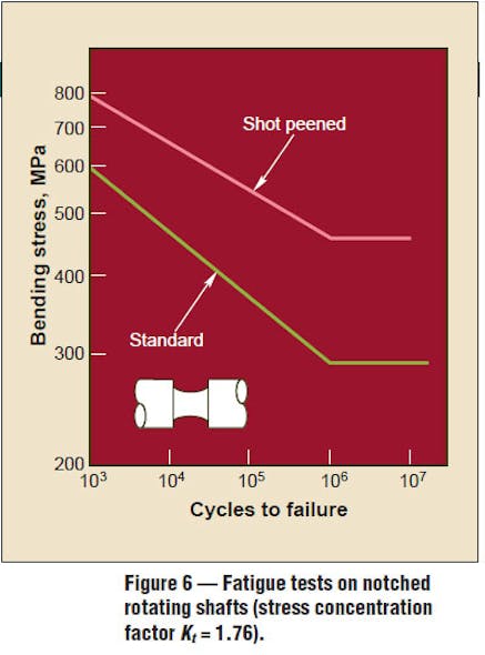

Shafts and axles. Many types of shafts and axles are shot peened to improve their fatigue properties, Figure 6. In some cases, peening is required only in keyways, splines, fillets, shear sections, or other section changes.
To protect driven equipment, many shafts have a shear section that fails when the shaft is overloaded. Because the shear section is thinner than the rest of the shaft, fatigue failures often start at this location. Shot peening the shear section increases shaft life, while retaining the overload protection.
