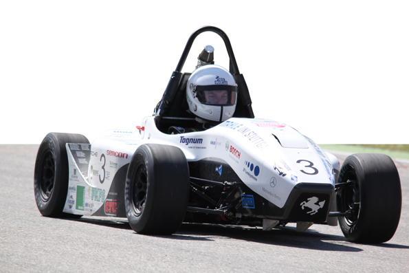

Shown here is the Uni Stuttgart team’s race car. The Formula Student Germany 2014 competition will be held July 29th to August 3rd at the Hockenheimring, just south of Mannheim. The event is comprised of a Formula Student Combustion (FSC) and Formula Student Electric (FSE) race. Currently there are 75 registered teams and 55 teams on the waiting list for the FSC. There are 40 registered teams and 32 teams on the waiting list for the FSE.
