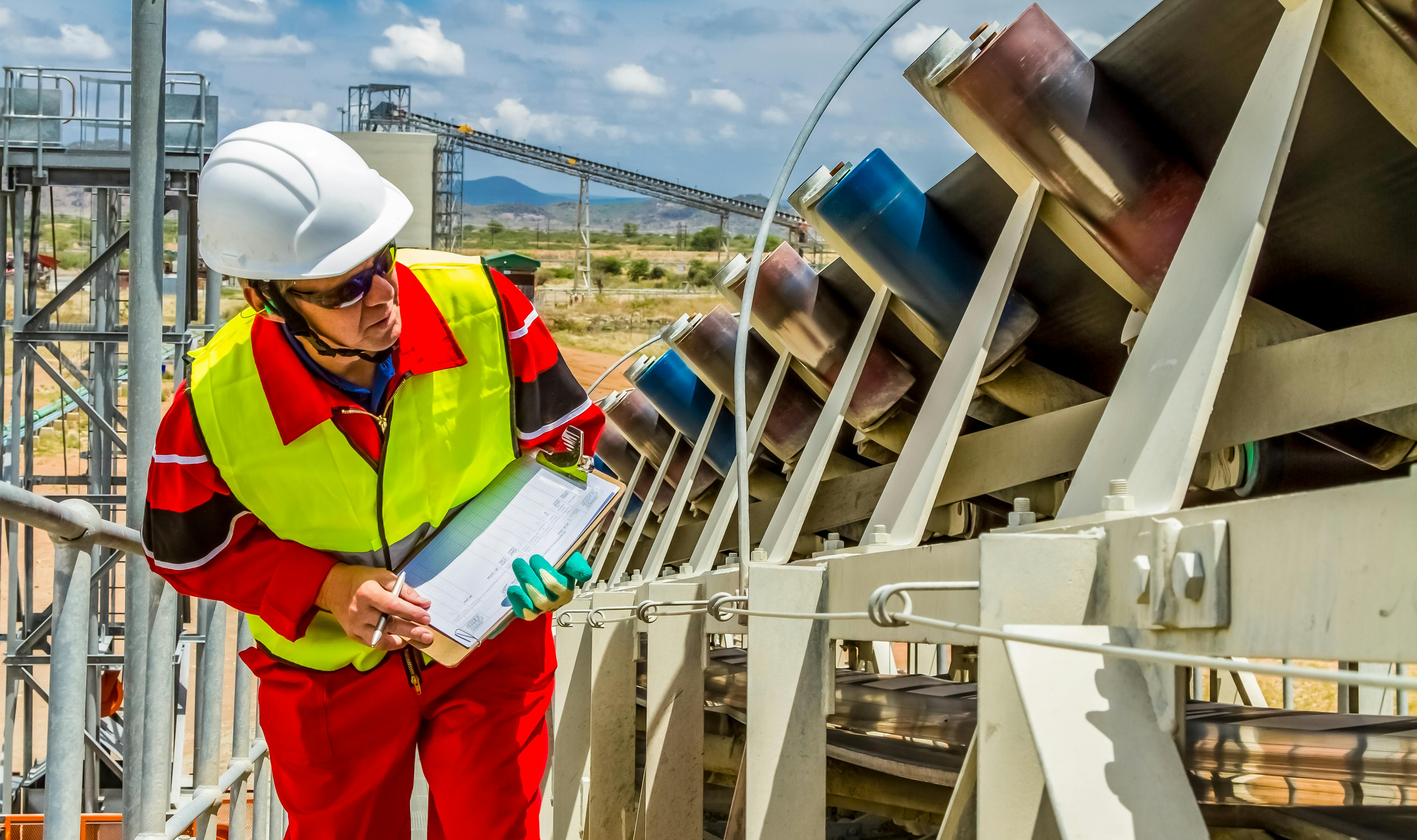

Figure 2 shows an example of abrasive wear operating on a snack food manufacturing conveyor. Abrasive wear is typically associated with applications that involve abrasive particles such as sand, coffee, wood chips or coal. Certain plastics including UHMW-PE (ultra-high molecular weight polyethylene) and hard cast polyurethanes tend to have outstanding resistance to abrasive wear (Budinski, 1997).
Figure 3 illustrates rolling contact fatigue, which is typical for plastic components such as wheels or conveyor rollers where the parts experience repeated cyclic stresses during rotation and Hertzian contact with mating surfaces. Certain plastics such as acetal and PEEK tend to have good resistance to material loss from rolling contact fatigue, resulting in long service life for wheels and rollers (Stolarski, 1993).
