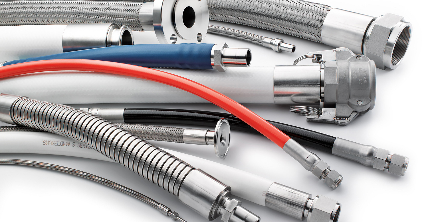

Fig. 1
Specify Hose Materials to Match Applications
Nov. 21, 2019
Here’s a look at the most common hose materials and what they are best suited for. There are also some tips on keeping costs for hoses to a minimum while still getting top-notch performance.
Selecting the proper hoses for carrying fluids and gases is critical for increasing uptime, safety, and cost-effectiveness. The wrong hoses, however, lead to unnecessary downtime, increased risks, and lower profits.
With so much at stake, what should design engineers, plant managers, and maintenance technicians consider when selecting and specifying hoses for equipment and machines? Hose life, maintenance, and replacement costs, as well as other ownership costs, all influence the final decision. To make the best choice, it is important that all stakeholders thoroughly understand hose material options, construction type, and end connections, as well as the application. Each of these factors makes a big difference in performance.
Every hose is made up of several key components: the core, end connections, reinforcements, and coverings. Here are some explanations of these components and how each can improve system performance, reduce costs, and enhance safety.
Hose selection requires making several design choices, including core tube material and construction, reinforcement layers, covers, and end connections.
