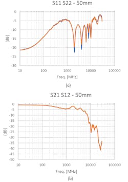

2. These are the S-parameters (a and b) for the 50-mm-long line.

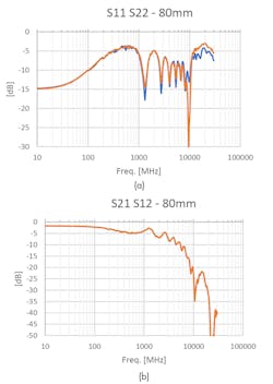

3. The S-parameters (a and b) for the 80-mm-long line are plotted.
For both lines, the values of the reflection parameters (S11 and S22) reveal relatively poor matching above 100 MHz. Due to the resolution limitations of the printing process, and this being a preliminary test, the impedance of the lines was deliberately not optimized. However, it’s feasible that implementing an impedance transformer could solve this matching problem. Furthermore, in both cases, S11 and S22 are almost identical at each frequency, suggesting that the soldering process for the SMA connectors has good repeatability.
The transmission parameters (S12 and S21) for both lines show acceptable performance up to 2 GHz and possibly beyond, once the design has been optimized to reduce the mismatch from the VNA test port connectors. The transmission losses, summarized in terms of S21 at specific frequencies for all four lines, are shown in the table.

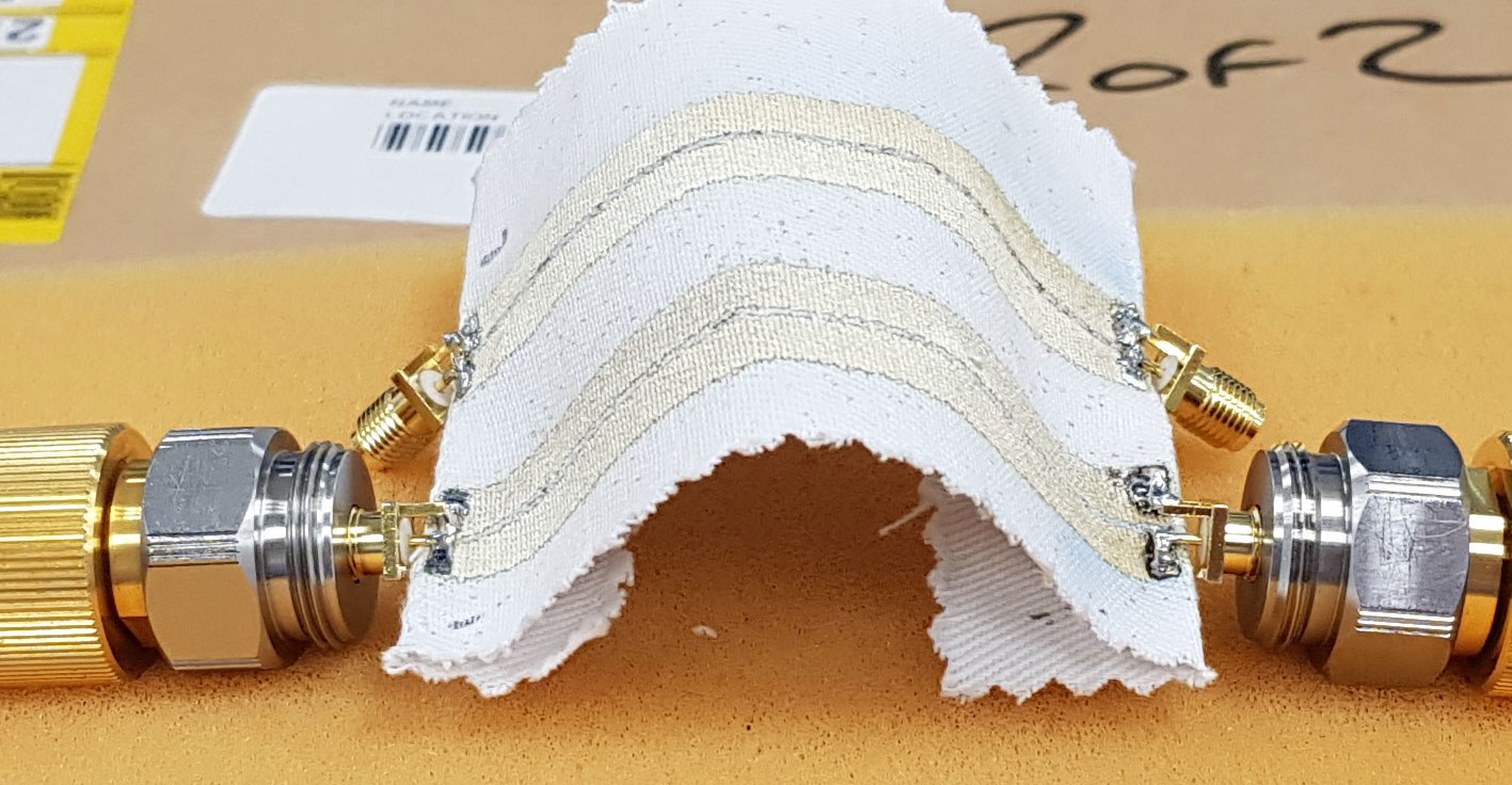

8. Four different test conditions were applied to the fabric transmission lines: U-bend (a), wiggle (b), misaligned (c), and 180° twist (d).
Finally, the lines were tested under different distortion conditions of the fabric substrate (i.e., flat, U-bend, wiggle, misaligned, and twisted) (Fig. 8). Figure 9 shows the results for all of these test conditions. There’s very little variation in the measured performance as a result of these different test conditions, with only slightly larger losses in the wiggle configuration. This may be due to the formation of coupling between different sections of the line, as suggested by the shift in the observed peaks for these transmission lines.
