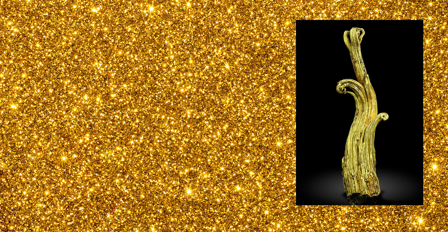

A team of researchers at Los Alamos National Laboratory scientists has peered inside one of the most unique examples of wire gold using neutron characterization techniques. It has helped the researchers understand the specimen’s structure and possible formation process. The 263-gram, 12-centimeter tall specimen, known as the Ram’s Horn, belongs to the collection of the Mineralogical and Geological Museum Harvard University (MGMH).
“Almost nothing other than the existence of the specimen is known about wire gold,” says Sven Vogel, a physicist at Los Alamos National Laboratory’s neutron science center, LANSCE, a half-mile-long particle accelerator that provides high- and low-energy protons and neutrons for a wide variety of scientific research.
Found in 1887 at the Ground Hog Mine in Red Cliff, Colo., the Ram’s Horn is mysteriously shaped like a twisted bunch of wires instead of the more recognizable golden nugget. It has baffled mineralogists since its discovery. The unknown: What is its fundamental structure and how did it form?
“Some native metals or metal alloys found in nature can occur in what is called wire morphology,” says John Rakovan, professor of mineralogy at Miami University in Ohio. “Much more common in silver, the wire morphology is rarely seen in gold samples and this specimen is without question the finest known example.”
Because of its rarity and associated monetary value it is not possible to cut into or break open the specimen, and because of its density, low-energy x-rays and other diagnostics can only investigate exterior surfaces, so no scientific studies have ever been published on the internal nature of this specimen—until now.
This gold wire specimen was bequeathed to Harvard University in 1947 as part of the A.C. Burrage Collection. It is now housed in the Mineralogical and Geological Museum at Harvard, one of the oldest and continuously operating mineral museums in the U.S.
The research results suggest wire gold is very different from wire silver. “Wire silver is a mosaic-like polycrystalline aggregate with many hundreds to thousands of crystals in a single wire,” says Rakovan. “The gold appears to be composed of only a few single crystals. Furthermore, we discovered that these samples are not pure gold, but rather gold-silver alloys with as much as 30% silver substituting for gold in the atomic structure.”
“We knew that on the surface this gold sample was about 70% gold, but nobody knew if that was only true for the surface,” adds Vogel. “Using a neutron source we normally use to study materials such as uranium alloys and nuclear fuels, we verified that this sample is homogeneous, meaning the whole sample is a 70-30 mix of gold to silver.”
