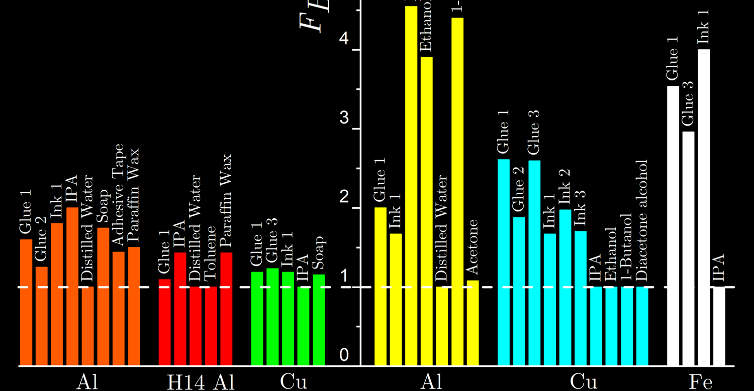

Cutting Force
Group-I media show consistent mechanochemical effects and force reductions of 50% independent of the metal to which they were applied. Group-II media show pronounced effects only with some metals. For instance, alcohols in group II—isopropyl alcohol (IPA), butyl alcohol, and ethanol—show the largest force reductions (nearly 80%) with aluminum, yet had no effect with Copper. Isopropyl alcohol, in particular, is the only common ingredient of media in group I (e.g., inks 1 and 2), yet shows no effect with Cu and Fe (unlike inks 1 and 2 themselves).
The results show Group-I media fall around the FC = 0.5 FB line, Group-II media on the FB = 0.2 FC line, and Group-III media around the FB = FC line (negligible mechanochemical effect). Al and Cu refer to metals in the annealed state.
This result is reflective of the strength or weakness of local adhesive bonds that form at the media-metal interface: The alcohols are known to form strong bonds with Al to such an extent that they may even corrode it to form the corresponding alkoxide. Likewise, distilled water and toluene (group III, little-to-no adhesion) show no effects with any of the metals.

When the sinuous flow is reduced or suppressed by changing the deformation geometry (angle of tooling) to α = 45 deg. (from α = 0 deg.), or by prehardening the workpiece (H14 Al), the extent of the force reduction is significantly smaller or absent altogether. Under these conditions, smooth laminar (steady) flow becomes prevalent. The mechanochemical effect is now much smaller—indeed, in most cases, negligible—pointing to a strong coupling of the media action to the flow type.
The ratio of cutting force for uncoated (FB) to surface-active media coated (FC) workpiece samples for various surface-active media-metal combinations and cutting conditions. Mechanochemical effects result in force reductions of as much as 80% (Al-IPA, α = 0◦). Al, Cu, and Fe refer to metals in the annealed state, while H14 is a half-hard condition for Al.
