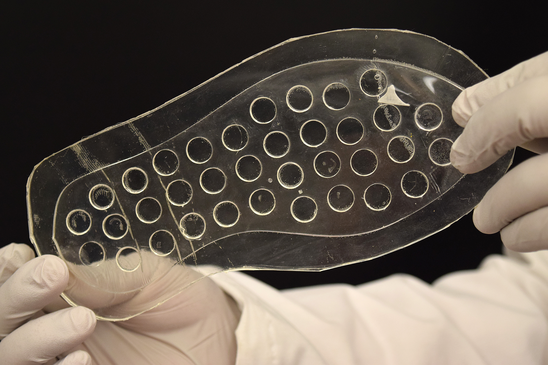

Purdue researchers used lasers to turn silicone-based rubber into insoles, then creating reservoirs in the insole that release oxygen only where the ulcer is. Silicone is flexible and has good oxygen permeability, and laser machining tunes that permeability at the wound site which needs oxygen, rather than poisoning the rest of the foot with too much oxygen.
According to the team’s simulations, the insole delivers oxygen for at least eight hours under the pressure of someone weighing between 117-179 lb. But the insole can be tuned to take on any weight, the researchers say.
