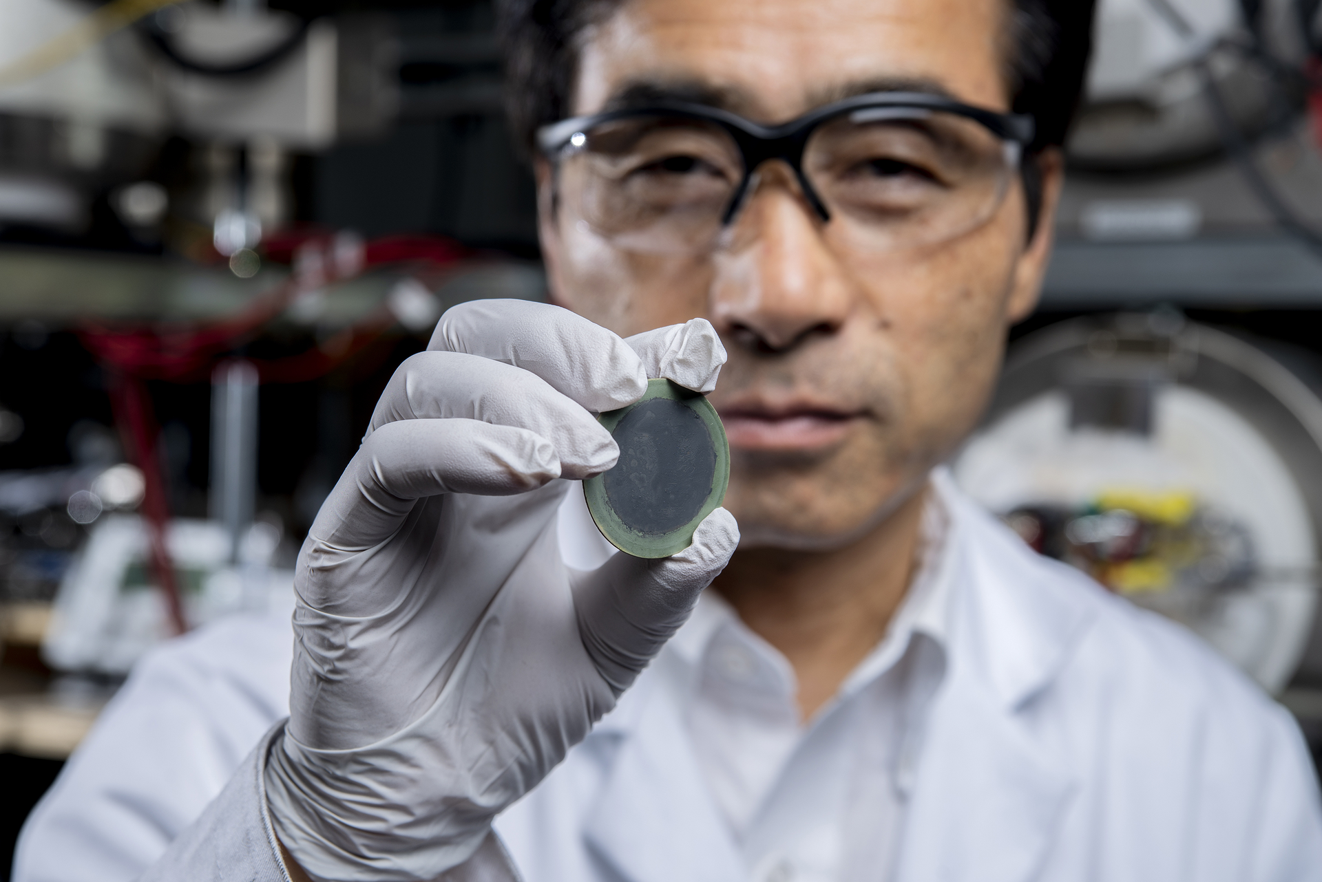

Cascading innovations, including a brand new one, let researchers reimagine the fuel cell, making it run on methane at lower temperatures. The ruthenium-nickel based catalyst, here in green, was the latest materials innovation in the new fuel cell. (Credit: Georgia Tech/Liu lab)
