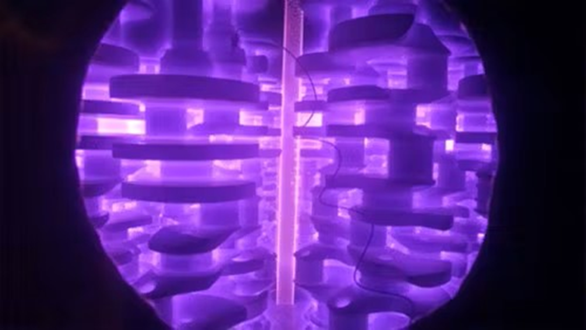

A part being ion nitrided in a vacuum chamber. The purple glow stems from a plasma discharge around the part.

Ion nitriding is best for selectively nitriding as it lets parts be masked off from the ions (plasma) to prevent nitriding. It is done by applying a potential electrical difference across an anode and the part (the cathode) in a vacuum. This potential difference forms a glowing, purple nitrogen plasma which forces nitrogen ions into the part’s exposed surfaces.
Plasma nitriding is well-suited to alloys, such as stainless steels, since it quickly breaks down passive oxide surfaces. Typically, ion nitrided steels have thinner compound zones than gas nitrided parts due to the plasma’s constant sputtering. But this can be an advantage for some applications, such as gears, where contact stresses could harm surfaces with too many compound zones.
