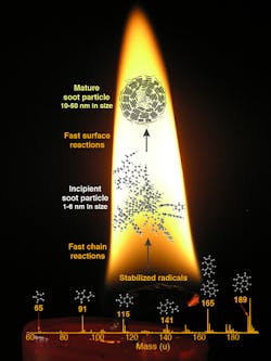

The mass spectrum at the bottom of the flame shows peaks for radicals driving the soot-forming reaction. The incipient soot particle shown between the two arrows is the cluster that marks a transition to the condensed phase. Fast reactions grow the particle shown at the top of the flame.
