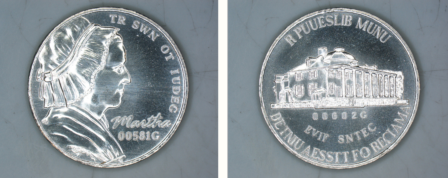

Nickels are ubiquitous in American life, but these resilient and somewhat humble-looking coins are also becoming costly to produce. Nickel, the coin’s own namesake, for example, has become a prized ingredient in many modern products, pushing the market value so much that sometimes making the five-cent coin costs as much as seven cents a pop.
Working with the U.S. Mint, a research team at the National Institute of Standards and Technology (NIST) has identified an alternative approach that would reduce the material cost for the nickel by as much as 40%. This approach would produce a coin every bit as tough and reliable as the old nickel, but also every bit as familiar.

The NIST team worked backward, first identifying the desired qualities for the new five-cent piece and then figuring out which alloys and procedures might be needed to make it. The U.S. Mint also outlined some site-specific constraints; namely, the new coin had to be made using existing manufacturing facilities in Denver and Philadelphia, both of which use a specific type of slow-cooling process.
Color proved particularly challenging. Although most people would not think of coins as having special tones or hues, coin collectors are a demanding group and will often reject coins even slightly off-tone—and collectors form a significant share of the market for currencies. The public might not trust coins that are too orange or too yellow. But color is often subjective, and one can be hard to quantify or reproduce with to any kind of reliable standard.
In this case, using the MGI process proved enormously helpful—surprising even the researchers with how efficient it was. Starting with the set of parameters for resilience, conductivity, and color, the team developed a new mix of copper, nickel, and zinc that was 40% less expensive than the currently used metal mix.
