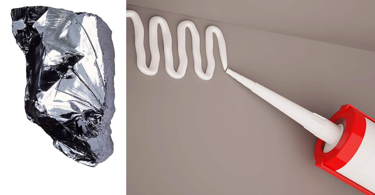

Raw silicon is a hard and brittle crystalline solid with a silver/grey-bluish luster. Once refined and purified, it serves as the basis for millions of semiconductors. (Courtesy: Thinkstock)

The principal component in silicone is polydimethylsiloxane, an inorganic polymer of silicon and oxygen. (Courtesy: Thinkstock)
