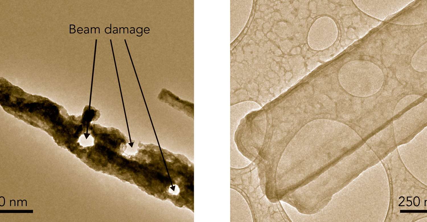

This room-temperature TEM image (left) shows how exposure to air has corroded a lithium metal dendrite and the electron beam has melted holes in it. In contrast, a cryo-EM image of a dendrite (right) shows that freezing has preserved its original state, revealing that it’s a crystalline nanowire with well-defined facets.
The team managed to get video of a dendrite curling up and melting when hit with an electron beam during transmission electron microscopy (TEM), which takes place at room temperature. It was also able to zoom in on a flash-frozen dendrite magnified about 400,000 times during cryo-EM imaging. Freezing protects it from the electron beam so researchers could see its intact structure for the first time, down to an atomic level.

“TEM sample preparation is carried out in air, but lithium metal corrodes very quickly in air,” notes Yuzhang Li, a Stanford grad student who led the work with fellow grad student Yanbin Li. “Every time we tried to view lithium metal at high magnification with an electron microscope, the electrons would drill holes in the dendrite or even melt it altogether.

“It’s like focusing sunlight onto a leaf with a magnifying glass,” Yuzhang Li continues. “But if you cool the leaf at the same time you focus the light on it, the heat will be dissipated and the leaf will be unharmed. That’s what we do with cryo-EM.”
