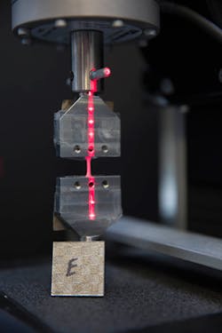

Thin plates of 3D-printed 316L steel were tested for both strength and ductility.
Deformation in metals is mainly controlled by how nanoscale defects move and interact in the microstructure. The cellular structure in the printed metal acts a filter, letting some defects move freely, and thus provide ductility, while blocking some others to provide strength. Observing these mechanisms and understanding their complexity could allow engineers to uncover new ways to control the mechanical properties of 3D-printed materials.
