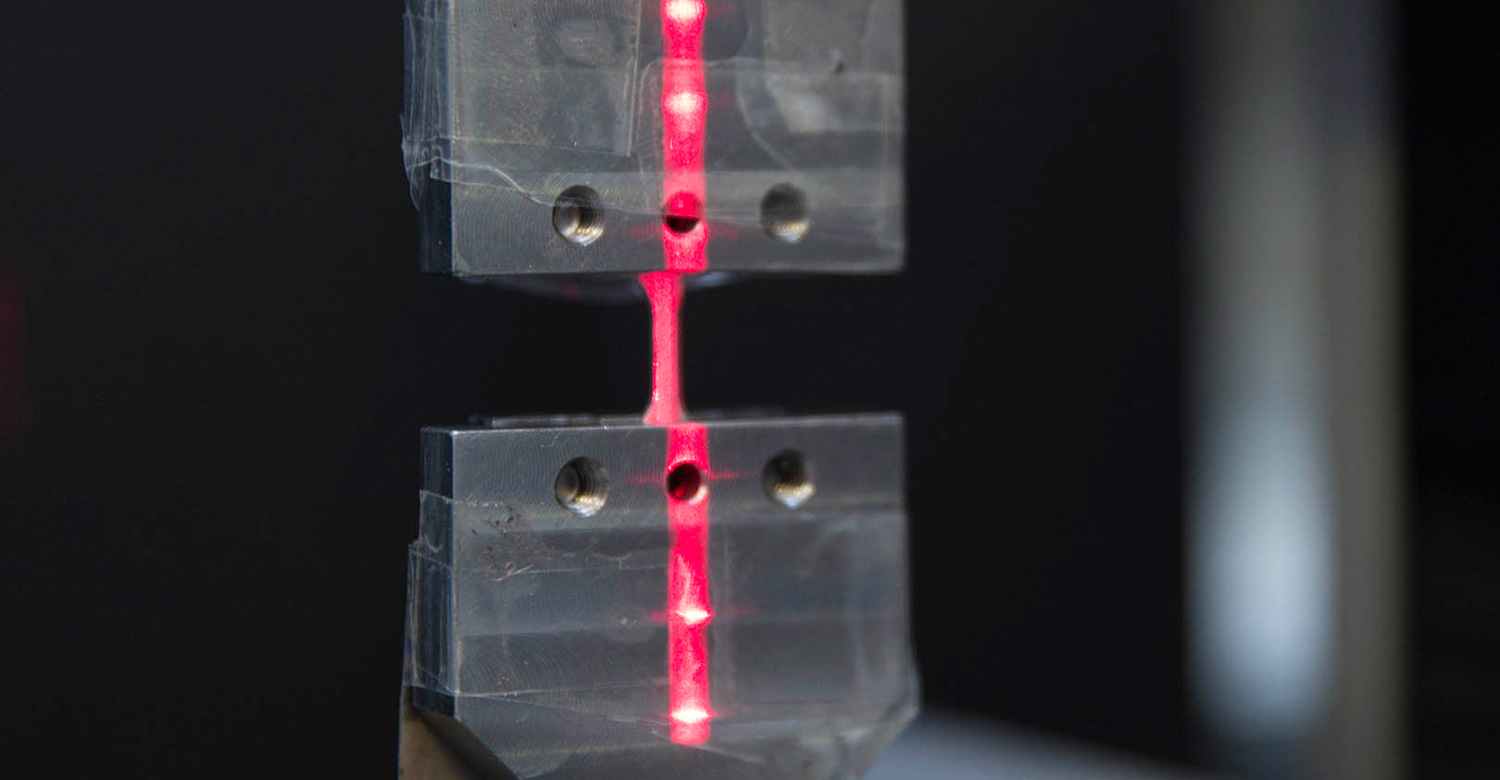

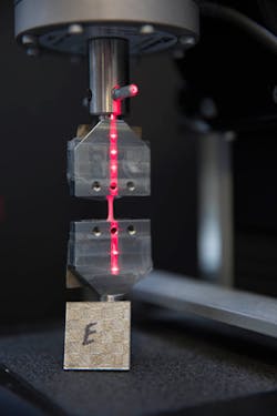

Using two different laser powder bed fusion machines, researchers printed thin plates of 316L steel for mechanical testing. The laser melting technique inherently resulted in hierarchical cell-like structures that could be tuned to alter the mechanical properties. The team discovered that when you additively manufacture 316L, it creates an interesting grain structure: The grains are not small, but the cellular structures and other defects inside of them are commonly seen in welding, and seem to be controlling the properties. This research could provide new insights into the structure-property relationships of additively manufactured materials.
Thin plates of 3D-printed 316L steel were tested for both strength and ductility.
