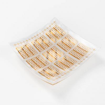

The team’s most recent work is published in the journal Applied Physics Letters. It investigates the use of graphene-based field effect transistors (GFETs) on a flexible polyethylene terephthalate (PET) substrate. The substrate was chosen because its dielectric properties minimally interfere with graphene’s electrical performance. In addition, its strength and flexibility are similar to graphene’s, allowing bending of the device with minimal effects on its signal-to-noise ratio and voltage characteristics. The team's next research phase will involve integration of the GFETs on a dielectric graphene substrate. This will enable even better electrical characteristics on a thinner, flexible graphene sheet.
At room temperature, the device detects signals between 330 to 500 gigahertz—a spectrum that can be applied with terahertz cameras, sensing and diagnostics in high-periodicity materials, and even skin-cancer detection. It can be bent into many shapes for new capabilities in scanning of uneven surfaces and integration into electronics with more complex designs.
