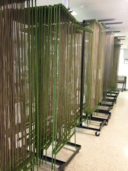

The number of coated guidewires used by medical practitioners, for cardiac, oncological, and other procedures is staggering. For each procedure, the low-friction coating on the surface of the wire provides the predictable “touch” so necessary to the operator. (This photo is courtesy of SSG.)
