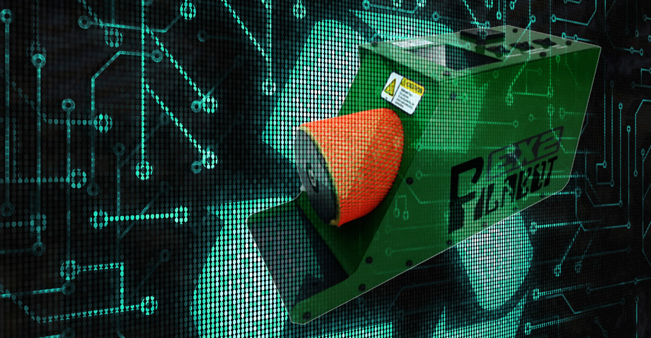

At Maker Faire 2015, Filabot displayed its multiple desktop solution, which allows users to extrude or pelletize recycled or new types of plastics.

Despite this, I am curious if anyone is trying to recycle PET bottles or any of the other economy polymers into 3D-printing filament. I think it would be interesting to collect some bottles, process them into a Filabot, and print parts.
