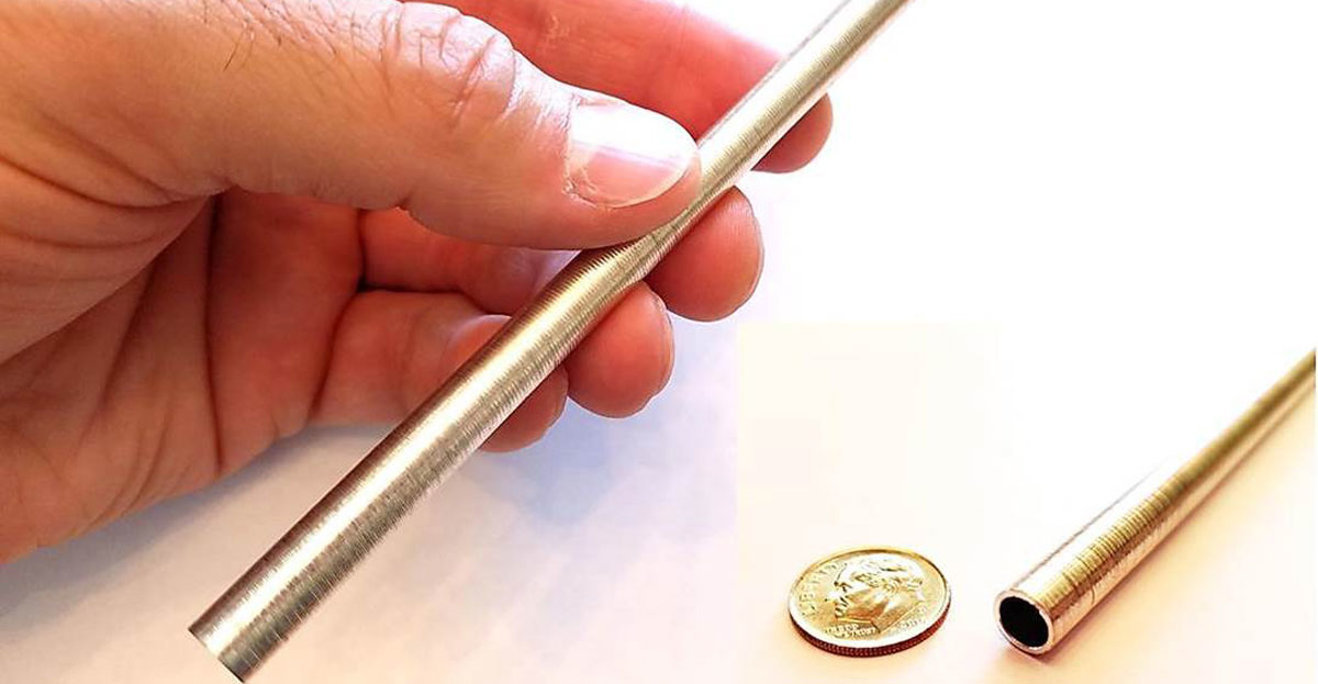

The trademarked process, Shear Assisted Processing and Extrusion Magnesium (ShAPE), came about when researchers theorized that spinning a magnesium alloy during extrusion would create just enough heat to soften the material so it could be easily pressed through a die to create tubes, rods, and channels. Heat from the mechanical friction deforming the metal also provides all of the heat necessary for the process, eliminating the need for power-hungry resistance heaters common in traditional extrusion presses.
The billets or chunks of bulk magnesium alloys that flow through the die are soft, thanks to the simultaneous linear and rotational forces of the ShAPE machine. This means only one tenth of the force is needed to push the material through a die compared to conventional extrusion.
This significant reduction in force should enable substantially smaller production machinery, thus lowering capital expenditures and operational costs for industry adopting this patent-pending process. The force is so low that the amount of electricity used to make a one-foot length of two-inch diameter tubing is about the same as it takes to run a residential kitchen oven for just 60 seconds.
The PNNL team designed and commissioned an industrial version of their idea, a custom-built Shear Assisted Processing and Extrusion machine (while coining the ShAPE acronym). With it, they’ve successfully extruded thin-walled round tubing, up to two inches in diameter, from magnesium-aluminum-zinc alloys AZ91 and ZK60A, improving their mechanical properties in the process. For example, room temperature ductility above 25% has been independently measured, which is a significant improvement compared to typical extrusions.
