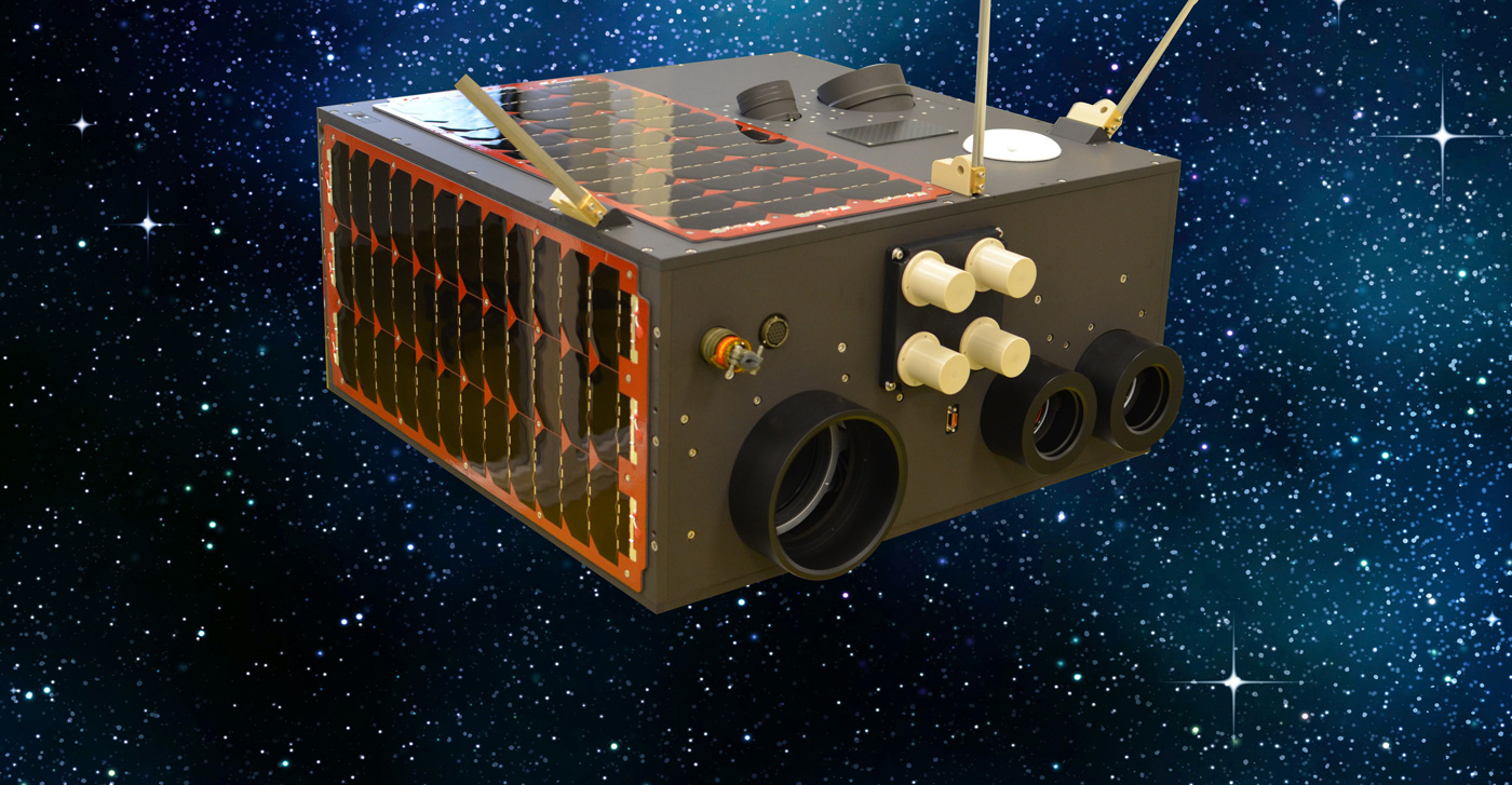

The pinnacle of optical application has already been field-tested with the National University of Singapore’s Kent Ridge 1 star tracking microsatellite, which launched in 2015. Its mission is to monitor Earth’s climate and ecosystems, as well as any environmental disasters that may occur during the satellite’s operational lifetime. One of the ways it maintains an equatorial orbit is through the use of star trackers mounted to the side of the satellite, which was coated internally with Vantablack. This allows them to absorb all “incident light,” or stray light, entering the imaging sensors. This provides increased accuracy in positioning based on star maps, which can be difficult with the amount of reflected and stray light coming from the sun and other stars.
