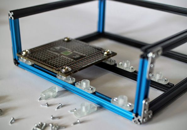

Sometimes called T-slot extrusions, these specially shaped aluminum bars manufactured via the extrusion process. They can be cut to length and assembled into just about any configuration you need. Extruded profiles are like the engineer’s erector set. Because they are made of aluminum, they are easy to cut, and because of their shape, they are extremely adaptable. Just add parts and accessories to them as needed. Whenever possible, I use aluminum profiles for the skeleton of machines and fixtures because I know that if something needs to be changed or added later, it won’t be a problem. Once the useful life of a fixture has run its course, just take it apart and use the profiles for something else. Learn to use extrusions. They save a lot of time and money, and the end result is almost always very professional looking.
The smaller-dimension profiles are perfect for building frameworks for screens, sensors, and single board computers. If you intend to construct something involving robotics, the small profile extrusions are a great place to start.
A custom NanoBeam frame with standoffs for electronics.
