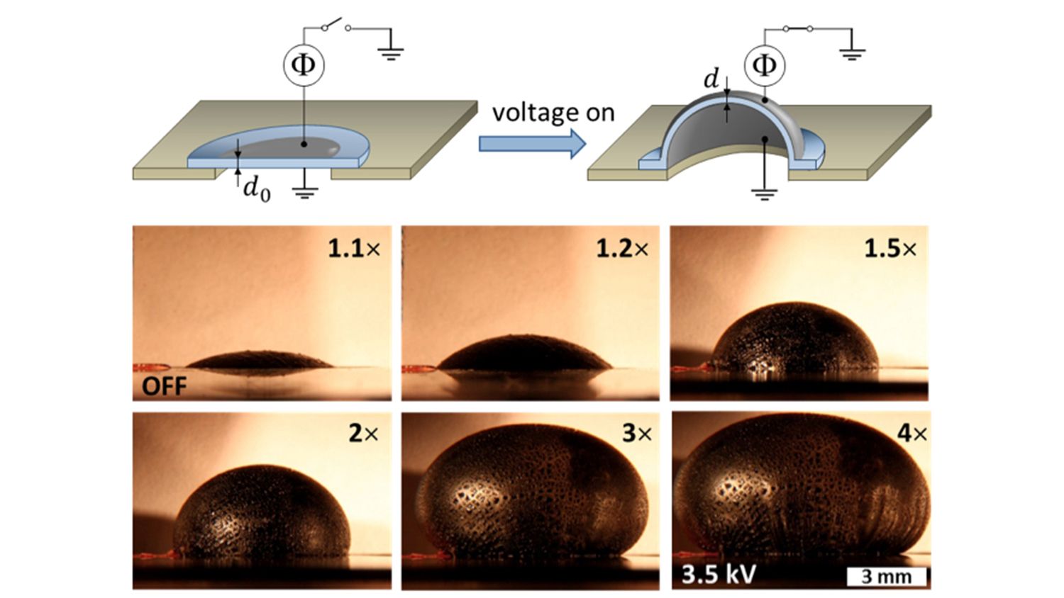

A circular sample of the bottlebrush elastomer expands by four times its original size at 3.5 kV applied voltage. (Courtesy of North Carolina State University, Click to Enlarge)
The electroactive bottlebrush polymers also significantly reduce the electric field strength needed to activate the elastomer. Dielectric elastomers usually require electric fields on the order of 100 kV/mm to expand. However, the team saw expansion with electric fields on the order of 10 kV/mm in their circular sample (left).
