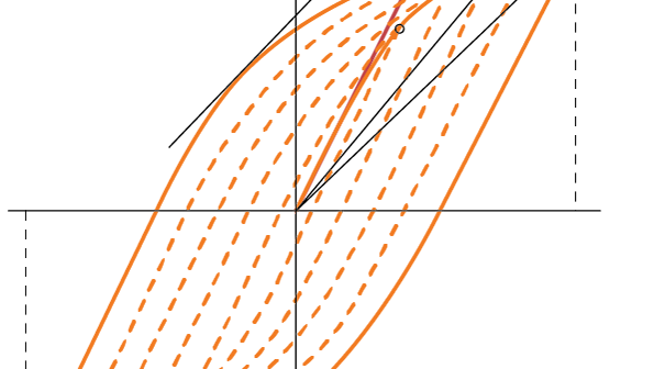

Static Load resistance normally implies stress-strain condition within the proportional limit, in which case Young’s modulus applies. The modulus is determined by the slope of the linear portion of the stress-strain curve via this equation:
E = σ/ε
Traditionally, Young’s modulus is used up to the material’s yield stress. (Yield stress is the stress at which a material begins to deform plastically. Prior to the yield point, the material deforms elastically and returns to its original shape when the applied stress is removed.) In many structures, stress concentrations (such as welds and joints) cause local yielding even though the applied stress is quite low. Local yielding arises when the applied stress is above the proportional limit but below the yield stress, which ranges from one-half to two-thirds of the yield stress, depending on the material’s ultimate strength.
For static loads above the proportional limit, the secant modulus must be used. This modulus accounts for local plastic deformation and resulting strain hardening or softening. The secant modulus is derived from the slope of a line connecting the origin of the stress-strain curve to the applied stress. Its equation:
Es = σa / εa = σa / (εelpl)

Impact resistance implies a wide range of modulus values depending on the stress distribution throughout a structure. Under impact, the kinetic modulus can vary from zero at the ultimate strain value to the elastic modulus. Resistance to motion under these conditions is described by the tangent modulus, Et, which is found from the tangent to the stress-strain curve or hysteresis loop. The equation for Et is:
Et = nEs = n'Ed

Vibration resistance implies a wide range of modulus variables depending on the amplitude of stress applied and the yield strengths of the material. Under cyclic loads, the relationship between stress and strain is described by a hysteresis loop, with the area inside the loop being absorbed by the material in one cycle.
Under cyclic loading, local plastic deformation neither hardens nor softens a material, so the material displays a variable resistance to motion. After about 100 cycles, the material stabilizes and resistance to motion can be described by the so-called dynamic modulus (also called the cyclic secant modulus).
Dynamic modulus accounts for strain hardening or softening and is found from the slope of the hysteresis loop. It’s equation is:
1/Ed = 1/E + εpla
where the relationship between ɛa and σa is again described by Ludwig’s equation except that K and n are modified to account for cyclic loading.
