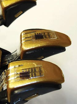

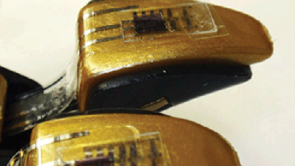

A human-skin-inspired multifunctional e-skin uses a micro ferroelectric material that can discriminate static and dynamic pressure and temperature. Professor Zhenan Bao and her team of researchers at Stanford Univ. are focusing on integrating solar cells, self-healing mechanism, and lights. Last year, they were able to synthesize materials with pigments that change color. (Courtesy of advances.sciencemag.org)
A close up of e-skin shows a grid like pattern in the film that is capable of sensing the “C” on its surface.
