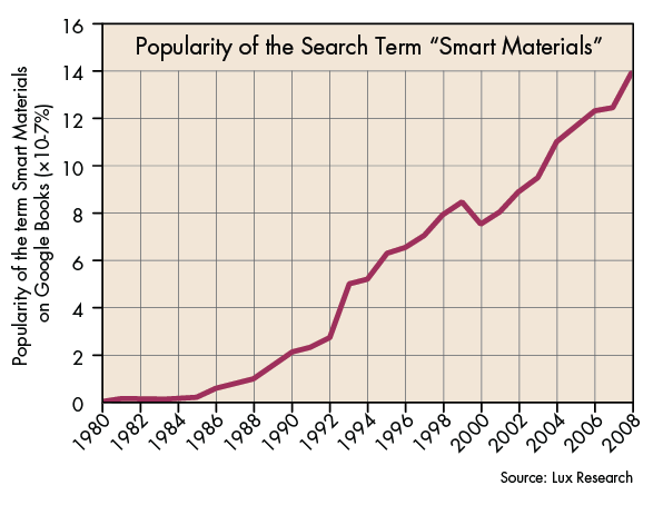

The term “smart material” originated over 30 years ago to refer to any material capable of changing its properties automatically in response to an external stimulus. The stimulus and response may be mechanical, electrical, magnetic, optical, thermal, or chemical. Since then, popular and academic interest in the topic has risen steadily. This trend is shown in the graph below of the rising frequency of the two-word term “smart materials” in print sources as tracked by Google Books (the y axis indicates how often the phrase “smart material” occurs as a percentage of all two-word phrases). Today, a host of conferences, journals, and textbooks focus on smart materials.
2. Chart of Smart Material popularity
