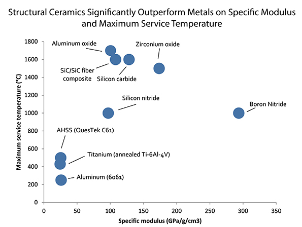

Structural ceramics possess exceptional high-temperature performance, and their specific strengths and moduli give ceramics what it takes to be high-performance structural materials. However, low fracture toughness is a barrier to adoption for all unreinforced ceramics. Structural ceramics behave fundamentally differently than metals and polymers; thus, creating a reference guide on how they perform (or fail to perform) is critical to our understanding of ceramics.
1. This table shows that the mechanical properties of structural ceramics stack up favorably to those of metals, with the exception of fracture toughness where ceramics are not up to par with metals.
The following table and chart show how structural ceramics stack up against metals.
2. Structural ceramics significantly outperform metals in specific modulus and maximum service temperature.
